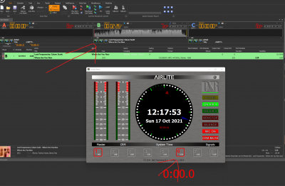

Hello when i open Propfrexx my GPIO client wont work anymore for my D&R Airlite
its connected in the GPIO client but when i put a slider up noting will play

radio42 wrote: 17 Oct 2021 08:01 What has changed since it was working last time?
that the Connection in the GPIO client not connecting anymore to Airlite
also Faderstarts dont work anymore
its like that the connection to airlite to the Radio software dont work
like the buttons work on the airlite only notings happen in the Radio sofware
also when in the GPIO client the D&R airlite is connected/online in the GPIO client the Airlite also dont work

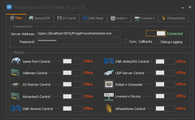

Note, that there are two connections:
1. Between DnR (resp. Velleman) and the GPIO client
2. Between the GPIO Client and ProppFrexx ONAIR
In the Last Screenshot above, the DnR connection is offline (eg. 1.)!
So this needs to be enabled. Can you do this and try again?!

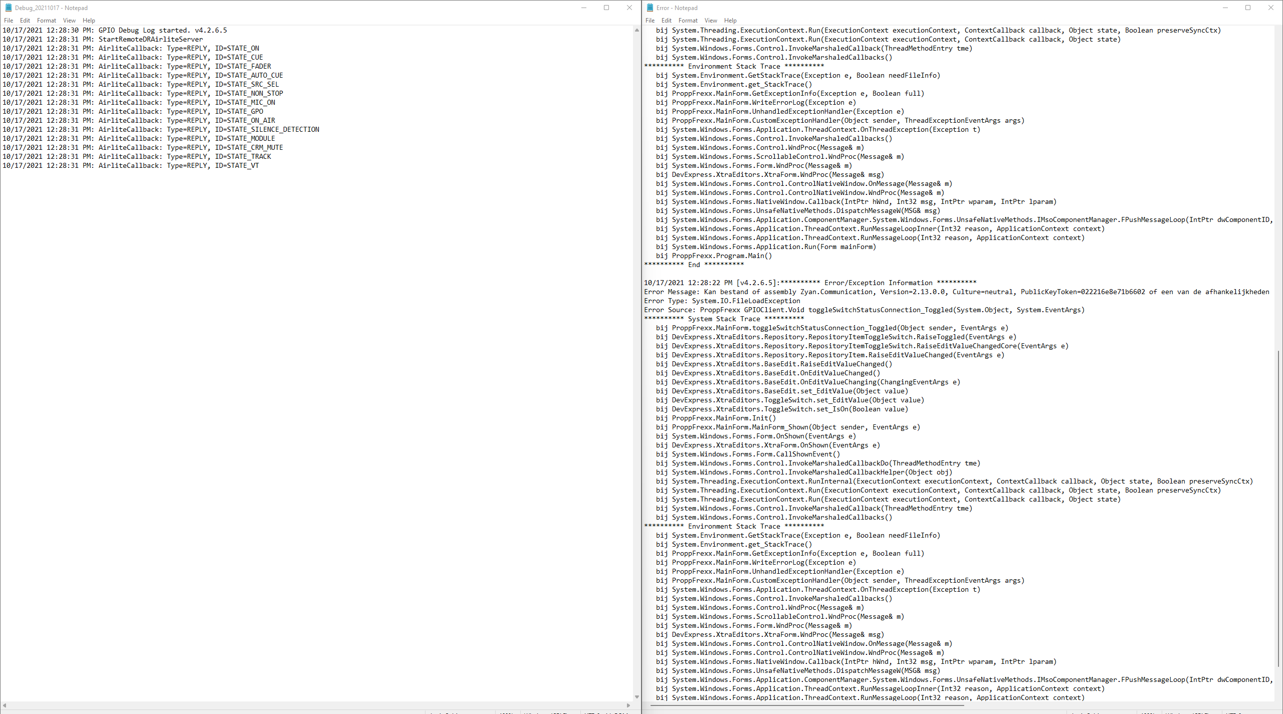

In the main screen of the GPIO Client you can enable the Debug Logging. The log can be found in the UserAppData folder of the GPIO Client. Please post its full output here

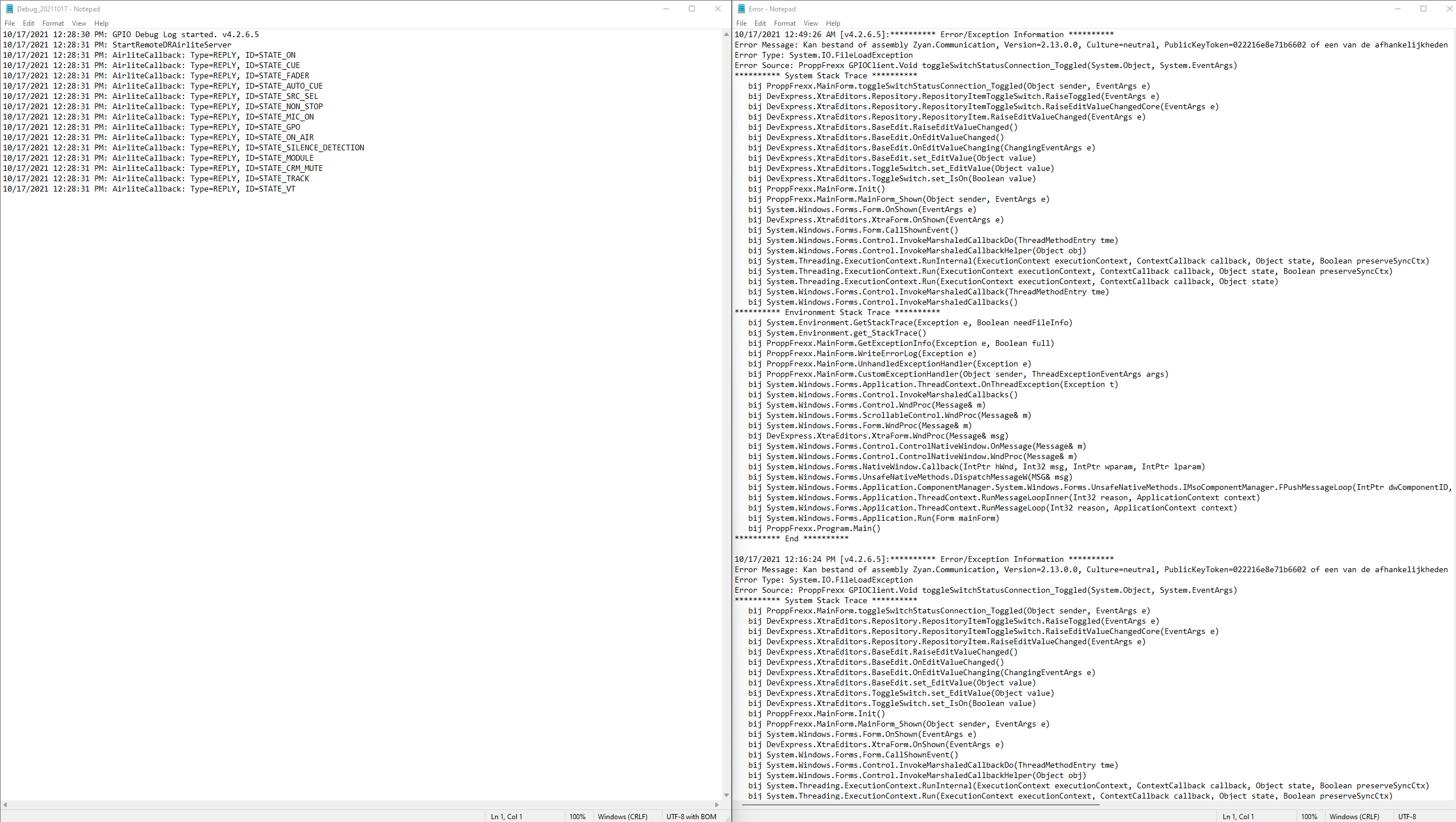

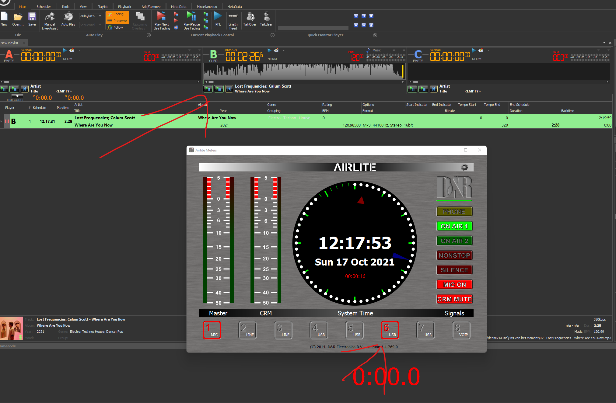

Here also the same problem with my Airlite , with the last update ( premium version)
Test of D&R message mapping shows that the fader response but when i pull the fader up nothing starts
Re: GPIO Client error
There seems to have been an update issue with the latest version, e.g. your GPIO Client application was not gracefully shutdown beforehand or some components could not be updated completely. Or you installed both
The debug log reports a version of a needed Zyan.Communication.dll of 2.13.0.0 - but the correct version needs to be 2.15.0.0!
So please check or update those manually.
