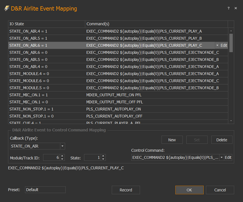

I've followed Benjamin Hartwich tutorial. In GPIO client > tab D&R mixer > Mapping, he uses the following to start player C when module 6 is activated:
I would like this to start Standby Player 1. Is this possible?
Something like STANDBY_PLAY_1

I am currently on holiday and return next week. But yes, you can!
I don’t have all commands in my mind, but the following should work:
STANDBY_PLAYPAUSE 1
For all control commands see the Appendix of the User Manual.

Great, this is working! Is there also a parameter for *all* standby players?
I've tried STANDBY_PLAYPAUSE ALL and STANDBY_PLAYPAUSE 1-99.
Thanks and enjoy your holiday!
