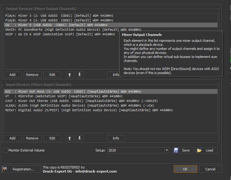

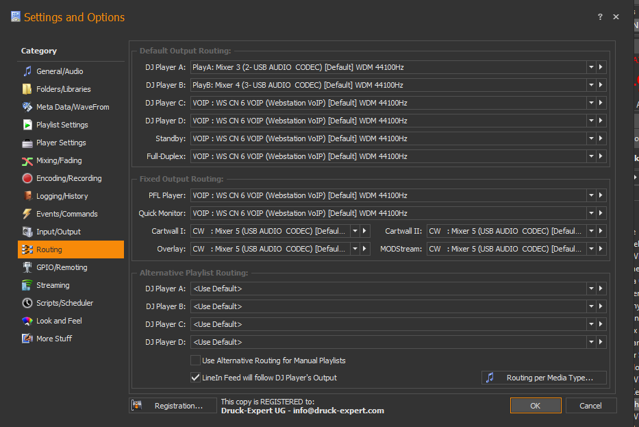

no, setup is Ok - piture
PFL Player - out put on 5 - not on 6

I am sorry to say, but your Mixer Setup might look okay, but when looking at the specifications of the Webstation, I guess it is NOT correct. But the devices from the Webstation, i.e. the drivers might pretend that all is okay, but unfortunately it is not.
The Webstation has 3 output devices:
- USB Audio Codec (Mixer 5)
- 2-USB Audio Codec (Mixer 3)
- 3-USB Audio Codec (Mixer 4)
The VOIP mixer channel which you are using and which is even listed as an output device for the PFL Player is NOT a real output device, but infact an input device!
Ie. there is no real output channel left on the Webstation.
The VOIP channel might be used (I don’t even know this), but in that case the Webstation might use the default, ie. the first output instead, ie. the Mixer 5.
As there are no 4 physical output devices on the Webstation (but only 3), your setup is not correct.
The confusion comes from D&R pretending to make you believe, that there are 4 output devices, but D&R doesn’t even provide its own device drivers… so these are unfortunately not optimal.
Maybe you can contact D&R for further complaints or clarification?
As said ä, I am sorry, but this is nothing ProppFrexx can solve for you unfortunately.

Sorry to correct you Bernd: The Webstation has 3 "normal" soundcards (fader 3, 4 and 5) but ALSO has a VOIP (fader 6) normally used with Skype calls or others. That VOIP is actually what DJSVEN is using for CW/PFL a.s.o.

ok its running now. it was not enougt to save the gernal setting. i must restart the software. than cane i youse the chanel.
