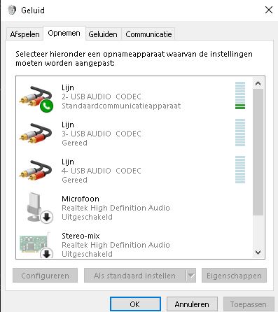

test performed via 'monitor' ?
correct sound settings windows?

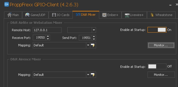

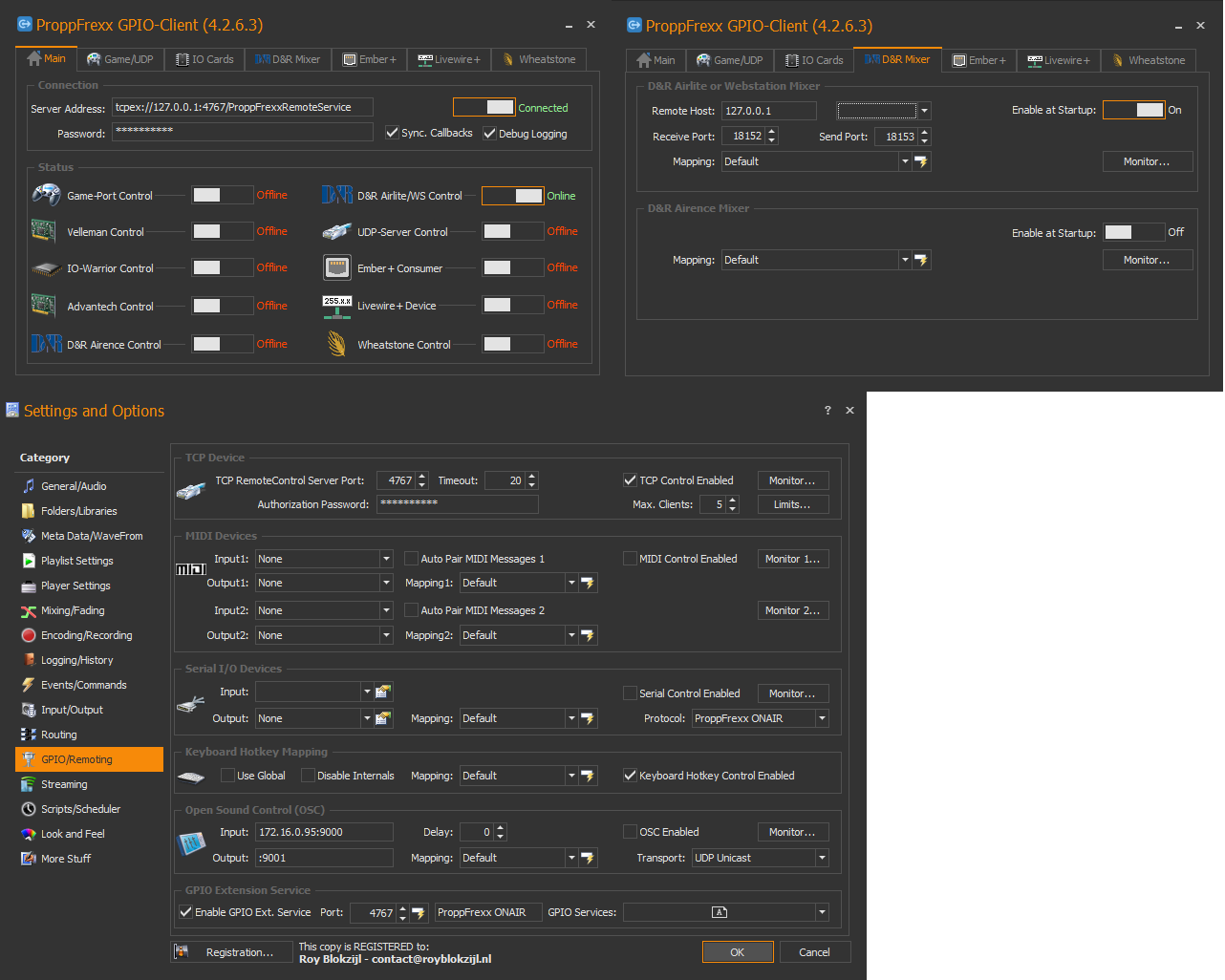

Is the GPIO Ext. Service enabled in ProppFrexx ONAIR?
And does the main screen of the GPIO client says it is connected?
And make sure you use the correct port, default is 9042.
Please send a screenshot from ProppFrexx GPIO settings as well as the main screen of the GPIO client.
If yes, please enable temp. the Debug logging and send me the debug .log file generates (or check yourself, if you can spot anything).
Note, you can enable it for both: ProppFrexx and the GPIO client.
The logs can be found in the AppUserData folders of each… eg. %appdata%\radio42\…

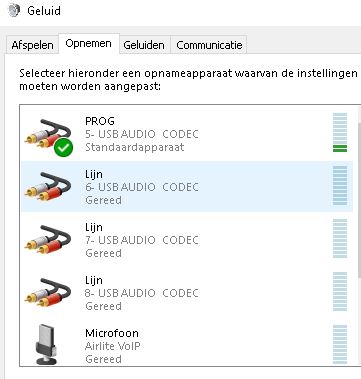

you wrote that my audio settings are the same as yours. check the following: connect an analog sound source to your webstation and check in your audio settings (windows) which input it is visible on, called PROG by me (see earlier picture). This PROG must be selected in Proppfrexx under Input Devices. Finally, despite turning off the firewall, set it up again.
- PF_prog.JPG (31.17 KiB) Viewed 15311 times

Here you can see my settings. Also the log of the GPIO Client.
and the code:
