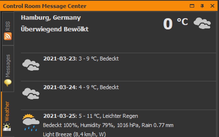

Re: Weather not working :(
Just tested it here and it works fine - see the attached screenshot.
I used my own private weather API key and my location - so please check, if any of yours is incorrect...?
