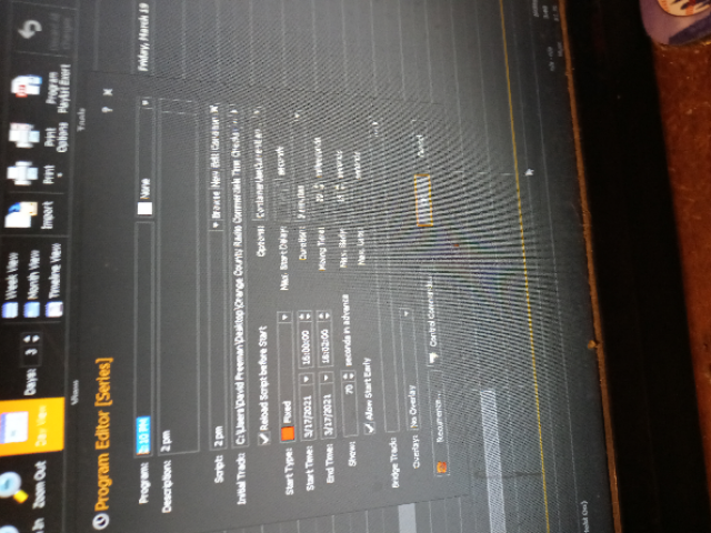

I'm not exactly sure how I set it up but I am attaching to PNG screenshots. I just did another test at 1600 with the test feature that's in the photo I didn't hear anything.
Dave -
Re: Scrip created for hourly ID Question
Beside the fact, that your program is only 2 minutes long and I don’t know how you tested things, eg. have you started your scheduler? Is it running?
Check the ‘Running’ tab button in the ‘Scheduler’ ribbon tool bar tab?!
Note, that it wouldn’t make sense to check the ‘Allow Delay’ program option, but set the start type to ‘Fixed’. Click on the ‘?’ Icon at the very top right to get help what the options mean , before changing them. But that is not related to your issue here, but just a side note.
I cannot really see your 2nd screenshot, as it is very small. Eg. you can also select the full text output of the Script test result and send that as plain text.
I cannot even see how you defined your ‘2 pm’ script.
Can you also post it?!

The 2nd screen shot is fine in general, BUT I need it much bigger! The above one is so small, that I cannot read it's content.
In addition I would need the content and details of the definition/configuration of the Script '2 pm'.
E.g. make another really readable (big) screenshot of it.
E.g. as shown in the tutorial video "Working with Scripts" : https://www.proppfrexx.radio42.com/foru ... f=5&t=1018

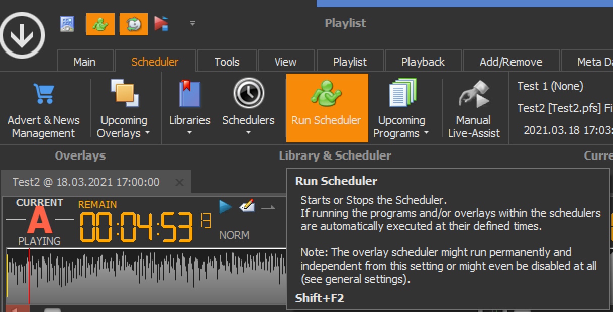

But the main question I asked was, if you started the Scheduler?
Just placing entries in the Program Scheduler (as in your screenshot 1) is not enough.
To really let it run, you must click on the 'Run Scheduler' button, as shown here:
Did you do that? Did you start the Scheduler?

I didn't see how to start the scheduler after I put the info in. Also I didn't see any place to save it.
davefrmn2019
Posts: 54
Joined: 10 Mar 2021 13:04
Post by davefrmn2019 »
Oh I did select run scheduler...
