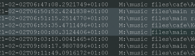

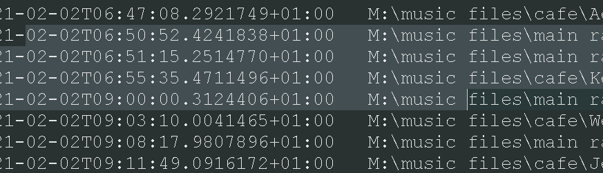

Yes. I am using the latest version of ProppFrexx application.
I have just opened the file located in C:\Users\admin\AppData\Roaming\radio42\ProppFrexx ONAIR\4.0\stat.
Looking for the live show transmitted over MODSTREAM.
The show in the stat file should be between 7:00 am and 9:00 am
And see like on the attached screenshot. Between 7:00 am and 9:00 am there is nothing about the modstream feed.

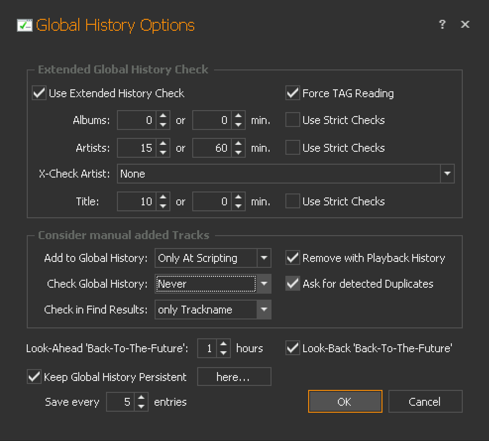

Additionally I've added more screenshot of the settings
