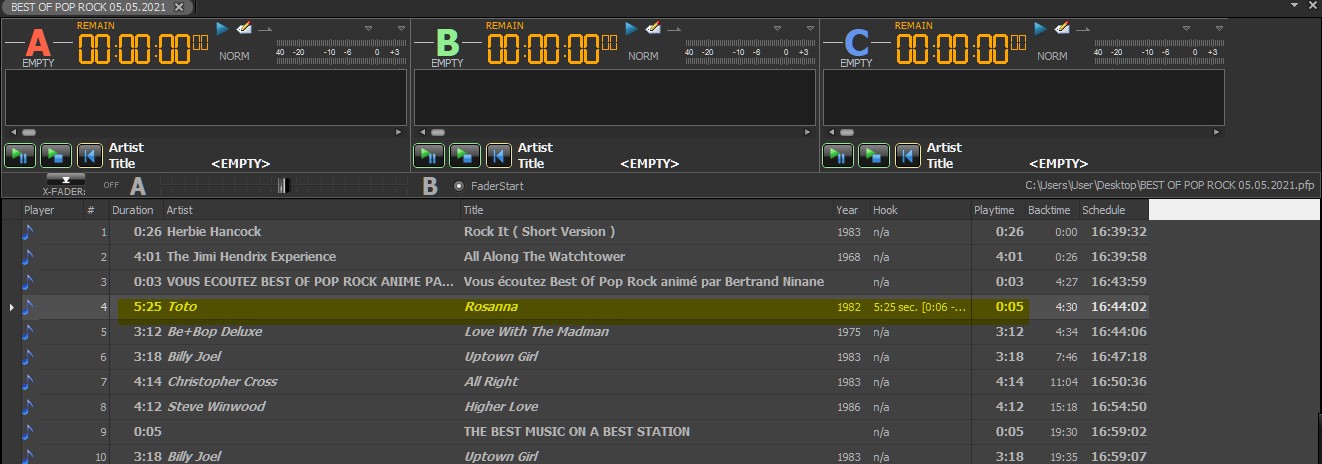

Impossible to save Hook for 3 tracks in the playlist. When i save the playlist (pfp) and i open then, erase all the hooks each time.

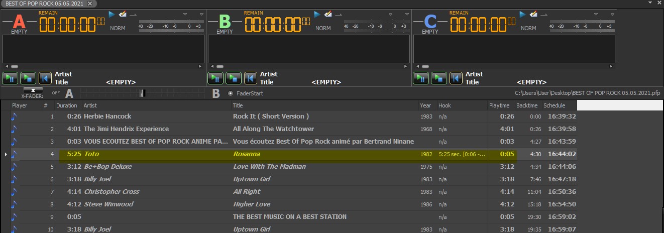

re open playlist but no hook is present
with hook then save playlist.

I guess your problem is still, that some of the meta data is probably saved at different locations?!
Where is your hook data stored? In the .pfp playlist file or directly in the audio file?

Re: problem with a playlist
This might be your problem?!
Eg. if you open a single track, eg. from the find window, or just add the track from the windows explorer to a new and empty playlist, you can open the TAG Editor to check, if it contains hook points.
If that is the case, the hook points are stored directly with the audio data.
Eg. deleting hook data only from a current playlist would not delete the meta data from the audio tag data.
But when using the TAG Data dialog (ALT+3) you can save any modifications back to the audios TAG data.
Are you doing that?!
