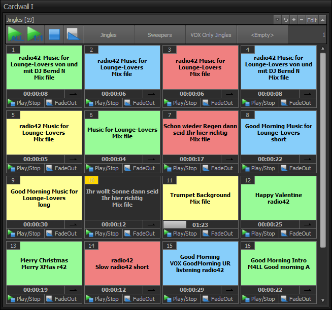

You once posted this picture:
How did you get the tabs that say 'Jingles', 'Sweepers', 'VOX only sweepers' there?

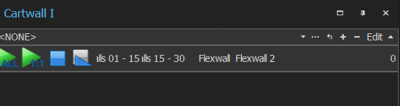

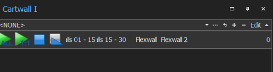

I have some old libraries there but cannot remove or change them:

Re: Cartwall tabs and workflow
Ctrl+Click: use and assign the current selected cartwall lib to that shortcut
Alt+Click: remove the current assignment
(just hoover over the buttons to get the tool tip)
The name displayed is always the name of the related cartwall lib assigned to the button - i.e. just name your libs accordingly.
