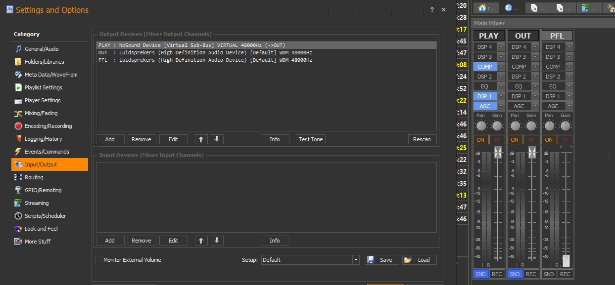

Due to problems with our streaming server we had to do a fresh install of proppfrexx.. Everything is working again als always.. only... no sound
These are our settings.. realy don't know why it isn't working anymore.

Have you used the 'Test Tone' button? Does that create a signal? Does that show in the level meters?
(and you should use the WASAPI mode instead of WDM)
Else, maybe incorrect routing of the Players?!
Else remove your DSPs - maybe they are muted?

yes, test tone works. and shows in the level meters.. And tried also the WASAPI mode.. nothing..
Will try remove the DSP's .

found the problem
it's the AGC.. gain was 0.
