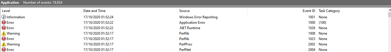

Faulting application name: ProppFrexx ONAIR.exe, version: 3.0.11.43,
Faulting module name: msvcrt.dll

So there does seem to be an error occurring with Net Runtime, reading that link you provided sounds very much that this is the same problem. Windows update did a new Cumulative Update for NET Framework 3.5 and 4.8 for version 1909 only two days ago and yet I still have the problem.
