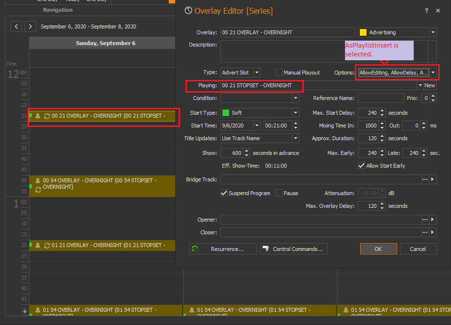

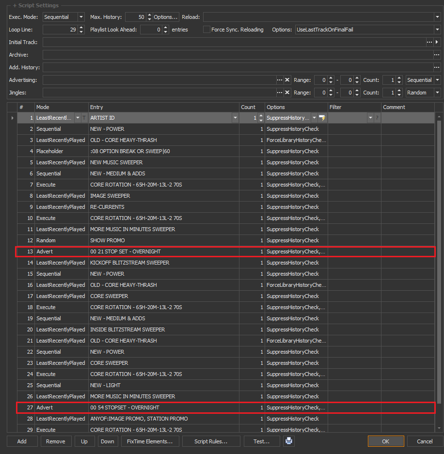

2. Regarding commercials, I notice that each stopset is loading two times in the playlist.
Conditions:
a. I have the stopsets scheduled in the script at :21 & :54. Those script lines are set to MODE: Advert, Entry: 00 21 STOPSET (which is selected from the created slots).
b. In the overlay scheduler, for all scheduled stopsets created, I checked the option "AsPlaylistInsert". I was thinking that this would load the commercials into the playlist INSTEAD of the upcoming overlays (which it appears it did), however also in the playlist is a container i guess from the overlay with the same commercial. I believe it was marked Suppress Overlay.

Script screengrab
Script screengrab
Overlay screengrab
Overlay screengrab
Re: Script Transitions
You have defined/used the advertslot twice!
Once referenced from the script and once referenced from the overlay!
Thus it is used twice in the resulting playlist!
One entry is coming from the overlay, which is resolved as a playlist insert and the 2nd entry is coming from the execution of the script.
So you should remove one! As if you define two in parallel you get two ;-)
I suggest removing the Advert script-lines!
