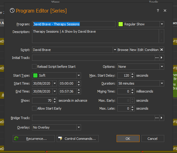

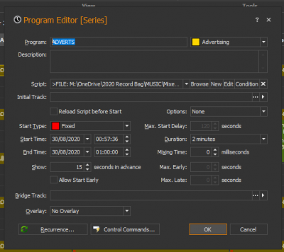

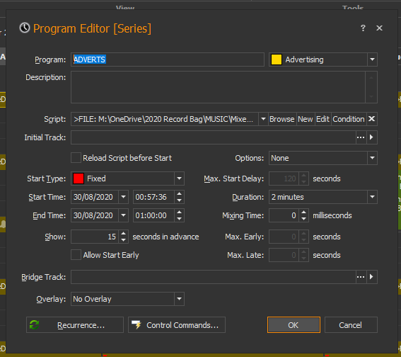

3. Ok New Question - I am essentially looking to give all DJS 57 minutes and 36 seconds of play time. after this, my in-house ads play. Have a look at the images attahched, as you can see in image 1, this shows that i have added a recurring advert. Have I done this correctly or is there a better way? (ill add an image for this as well)

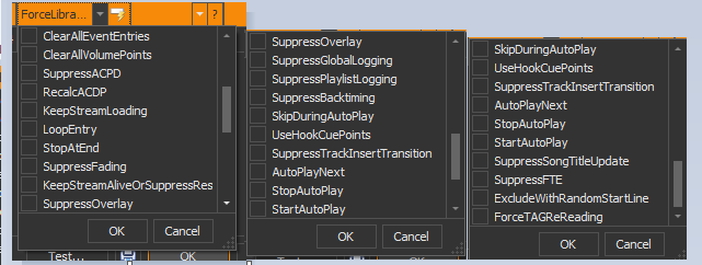

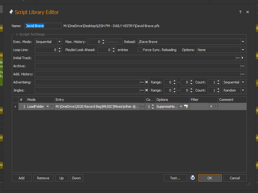

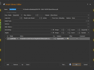

4.If you refer to image 2 and image 3 this is the first try at my new show script - 5PM each day "Therapy Sessions"
5. can i make this play daily except for 1 day? (Friday for example?) as i couldn't see that as an option
6. While i like the "FIXED" time slot, my next question on this is what happens to the output if the DJ mix doesn't go for the full hour? Some DJ mixes from the same DJ go for 50 minutes and some go for 15/35/45 minutes for example) is there just dead air?? i there a way to revert to a separate playlist that plays random mp3s until the Advert @ **:57:36 and then the next show can start?

advert image
Re: hour long DJ mixes advice?
Well, you could also have used the real Advert Management, but if your in-house ads are just one file, all looks okay. Eg. your advert program would stop your previous program and end it at a fixed time.
Just check how the next program is being started, eg. if you schedule that at the next full hour soft, your ad file must be long enough. You might also allow that to start early.
Click on the ‚?‘ icon at the very top right to get further help.
When a script is executed, each script loops once all script lines are used to query additional tracks. If you are using 3 DJ Players and has set the Scheduler LookAhead Option to 3 tracks (which is the default) initially 6 tracks are queried.
As your script only has 1 script-line, this would be called/used 6 times.
In order to only use the LoadFolder line once and to ensure you might query additional tracks in case the DJMix is short in time, please add a 2nd script line and use eg. the Random mode to select tracks from any of your Media Libraries.
Then set the LoopLine parameter of your script to 2! This will ensure, that the 1st script-line is only executed once and in case the script needs to loop it would loop starting with line 2.
For the recurrence you can select the Weekly option and then specify any week day to include resp. exclude in that weekly pattern.
So yes, it’s possible what you are looking for, you can repeat on any week day except Fridays.

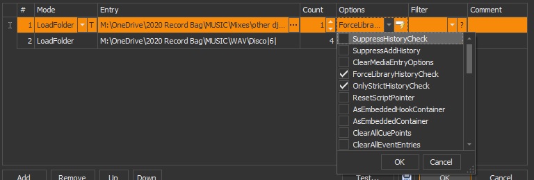

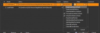

The only issue is that as per standard when I use the loadfolder function + creation time variable the option surpress history is default so essentially, it was loading the same DJ mix (that was created earliest) and playing it in the script so I tried *force history check* which seems to solve my issue however, I noticed today the fall back option (of loading random tracks) kick in with option ticked as, it looks like this option will play all files creation time, while checking history but, it's been played it won't play again.
So what I want it to do load a folder, read the creation time checked that if it's been played and if so skip but when it gets to the end, start again. How can I make do it do this?
As always thanks in advance 🙂
Then you also need to enable the script option: UseLastTrackOnFinalFail.

Also, i cant see "UseLastTrackOnFinalFail" am i missing something?
