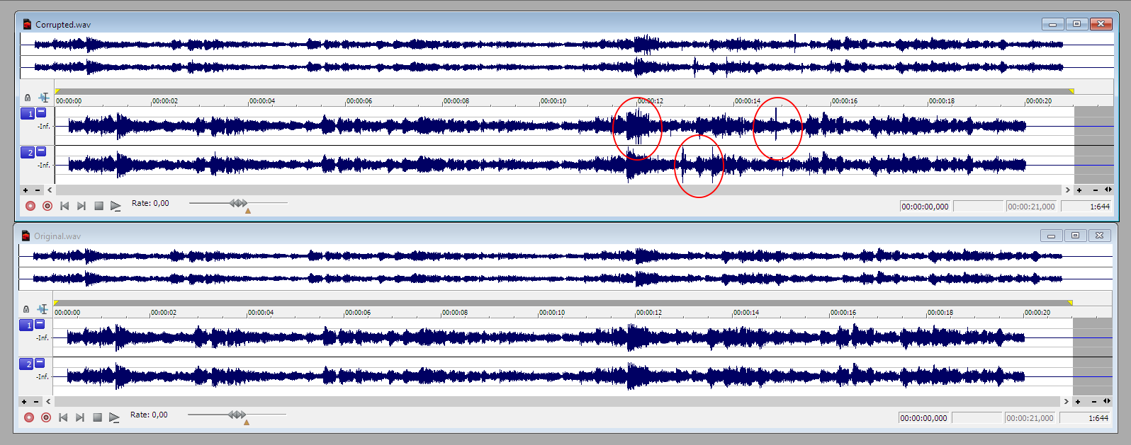

By corrupted, i mean audio artifacts added in the file. Some glitches. In every file where this happen, it's the same type of artifact.
You can hear the most in the end of the file.
I make a link with PF as it's the only program that access these files and the only program that actually add content (tags, etc) in the files.

I'm very sorry to insist but if you listen to the file i named "corrupted" you clearly ear the sound errors.
In attachment, a spectrum comparison. red stuffs are the errors.
It's not a soundcard issue as I just compare the WAV file on our PF system and the same WAV file from our backup server.
I really checked any other issue, like file system etc and there was nothing.
I've now changed PF settings to block writing to files and reloading whole backup...

Still, ProppFrexx isn’t writing to any audio data!
So what you are saying is physically impossible.
Have you excluded the possibility, that the errors have been added to the file from bit-errors happening on your hard disk?!

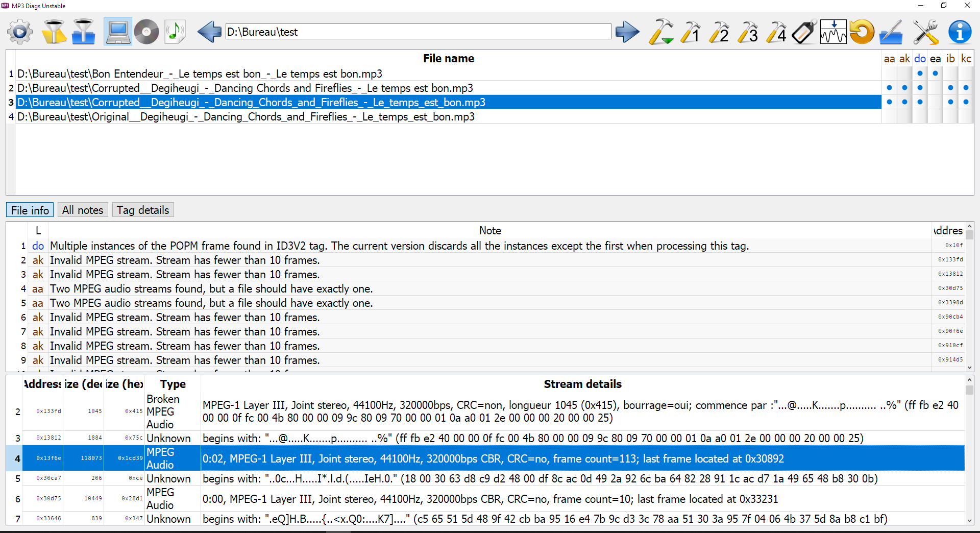

I also checked the newly provided MP3 files!
Please check yourself, but the Corrupted file is a re-encoded version of the Original file:
The Original mp3 is a contains 10260 audio frames and is of type CBR (constant bitrate)!
While the Corrupted mp3 file only contains 10183 audio frames and is of type VBR (variable bitrate)!
And the Corrupted mp3 file is indeed corrupt, as its frames are broken resp. some frames are missing - thus the slippery sound, as any encoder simply skips broken/invalid mp3 frames.
As already said: ProppFrexx wouldn't somehow magically and automatically convert a MP3 file or any other audio file!
Thus, there must be a program or tool running on your machine, which explicitly converts your audio files!

The file was not re-encoded, that's the problem ! That's the point that make me think of a program that may overwritten some audio data.
By the way the file is not VRB (clearly indicated in the image).
Original file size : 10 797 742
Corrupted size : 10 801 510
I just encoded a test version in VBR (320kbps, best quality) size is much lower -> 6 408 255
I runned a quick diag on the two file, the original is clean, no error. The corrupted has >180 errors.

Well, I used MP3checker and that indicated VBR for the corrupted file.
