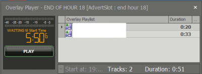

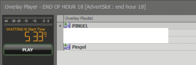

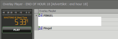

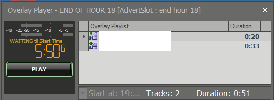

Attached 2 printscreens (fyi- the white fields are the customers)
Any advice how to get this solved?

Are these files accessible from the Slave computer?! Same path, drives available there as well etc.?
Are you using/referencing the same Advert Storage Path from the Slave PC?

You can turn on the Debug Logging on the Slave PC and send me the related Debug_...log file created to take a look at.
Plus post your screenshots of your related overlay entry configurations (where you defined the opener and closers) to look at them.
