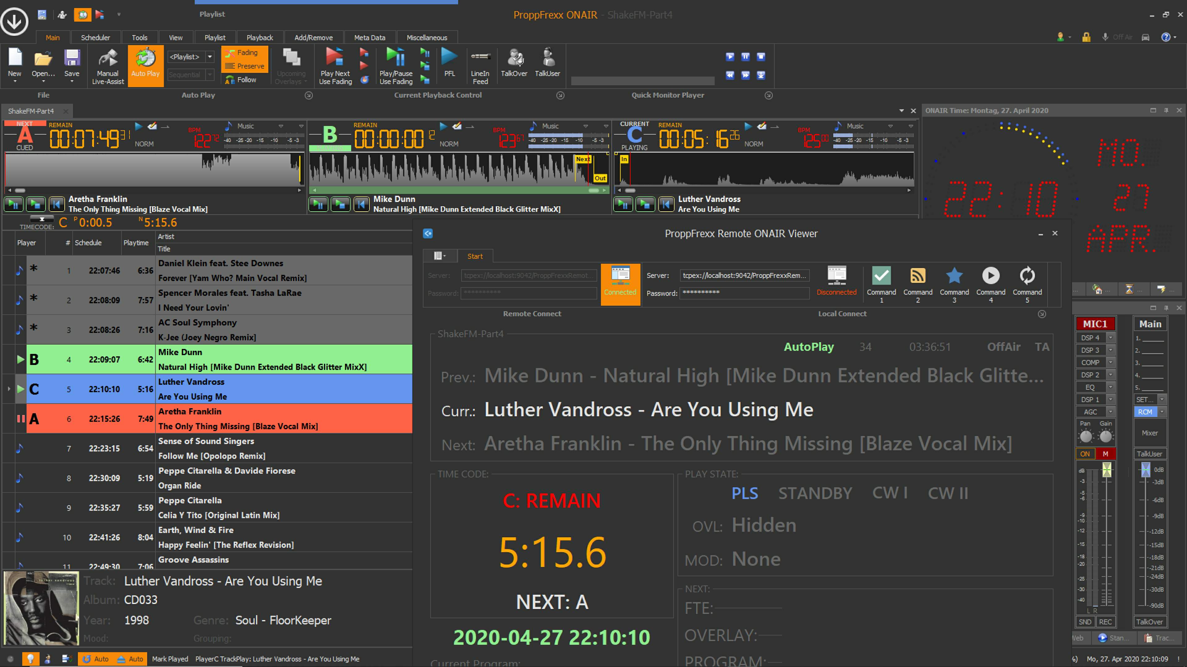

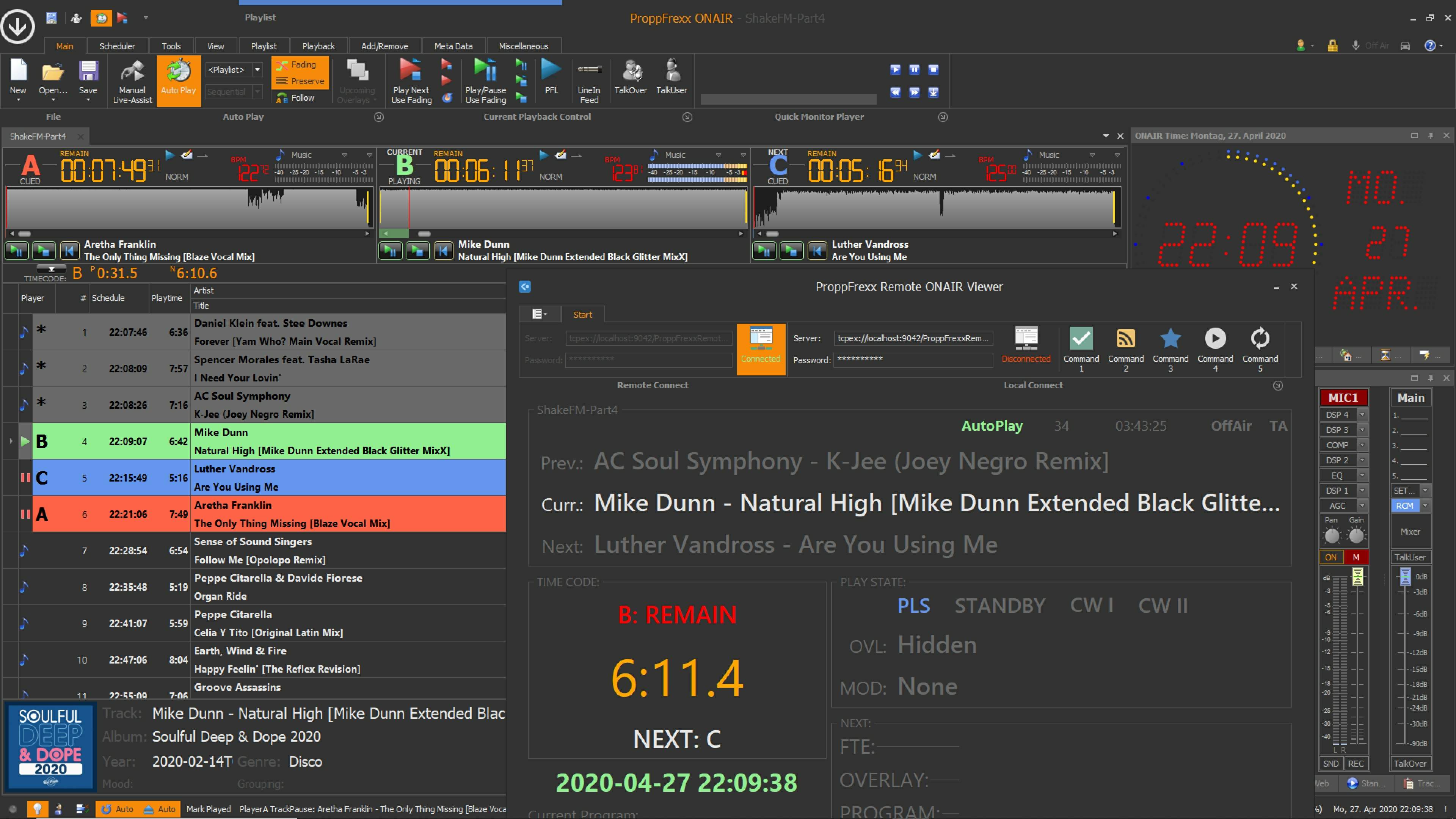

I've noticed song titles are not being updated. I've updated 2 studios to 4.1.5.13 from 4.1.5.5 are both are no longer updating meta data on the remote viewer. The main system was updated to 4.1.5.13 first but when I updated updating the studios the remote viewer no longer updated song titles(you have to disconnect and reconnect for it to update). I've kept the other studios to the older version unless resolved.

Just upgraded back to 4.1.5.13 and it’s the same again:
The counters(time remaining and overlay waiting,etc) and everything else works fine, but Prev.,Curr. or Next. is not updated.
I can see it counting down to the next song, but it never updates the titles until I disconnect and reconnect again. Everything else seems to display correctly.
