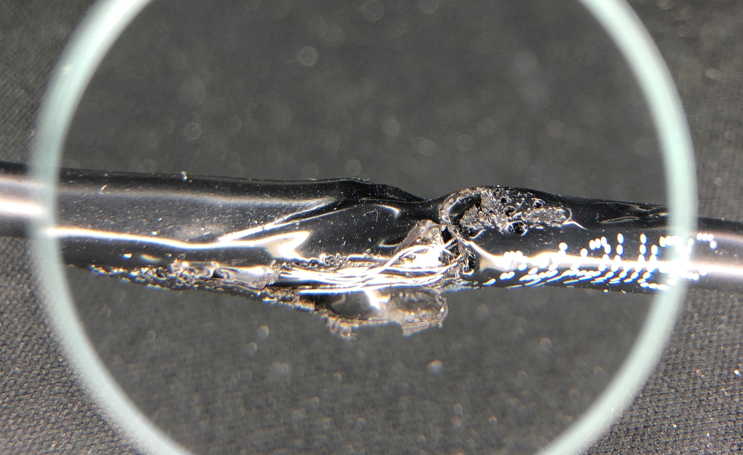

update: most likely it is the (original) usb cable between pc and Airlite that caused problems recently.Partially melted and exploded this morning, see picture!. Cable was free from other cabling so there are no consequences.
Re: lost connection GPIO-client
WoooW! That looks odd!
