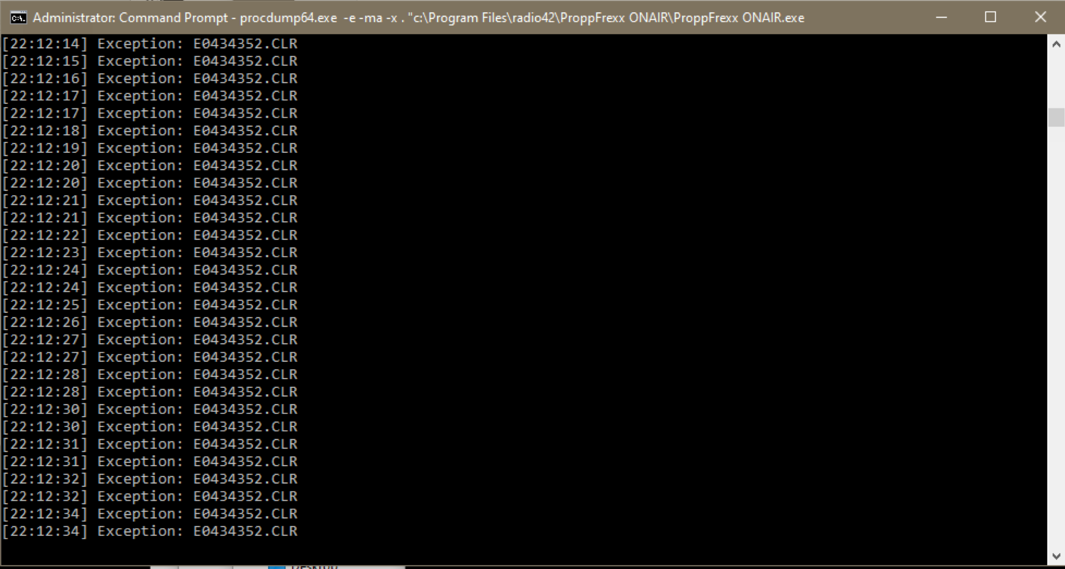

Just restarted ProppFrexx with Procdump64.exe but getting many exception errors as shown in the screen shot.
Re: ProppFrexx ONAIR quit with .NET Runtime error
Another way to get a dump file (instead of using ProcDump) is by applying this "localdumps-full" registry entry:
www.un4seen.com/stuff/localdumps.zip
Windows will then generate a dump file in the %LOCALAPPDATA%\CrashDumps folder whenever a crash occurs. After you have got a dump file for the crash, you can use the "localdumps-off" registry file to disable the dump file generation.
Please try this and send a crash dump file to me. THX
Could it be, that the crash is caused by a particular audio file (which is maybe corrupt)?
As in the 2nd crash it is again caused during the TAG reading.
Nor me or any other customer has ever reported such an error, as such, I believe it must be somehow very specific.
