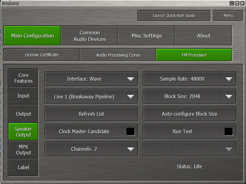

Hi guys, thanks for your suggestions. Currently I have my Breakaway One in a pipeline (on the same machine). I'm a nitwit when it comes to streaming and how to set this up. Is there some kind of manual available from PF how this would be possible the easiest way? I'm so curious how my sound sounds like when it is "on-air"!
Re: PF streaming with Breakaway One
To setup streaming, go to the ‚Network Streaming Monitor‘ panel and add a new Streaming Server.
Press on the ? Icon at the very top right to get help.
Esssentially you can define here which audio signal from which mixer channel you want to use as a source.
If you are using breakaway pipeline but not it streaming function, it would add its processing after the signal left the mixer output.
So you would need to feed it’s processed audio signal also back in as an input mixer channel and than use this as the source for streaming.

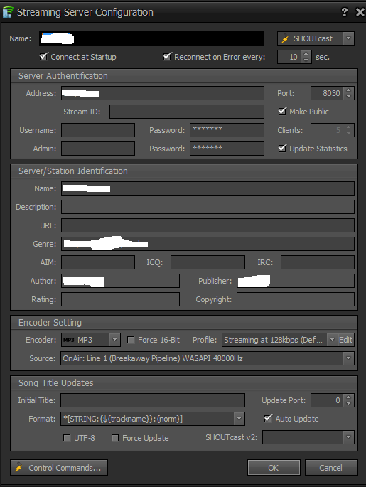

Hi, I now have my stream online, but I'm streaming from Breakaway One instead of PF. Works perfect, only issue that I now have is that the Artist - Song information is not shown on the Shoutcast server. I have read some posts on this issue, and it seems possible to get song information from PF to Breakaway. Anyone has this experience? I have the feeling the information from PF does not get to Breakaway at this moment. Thx, JW
By the way, here's my station located: http://84.24.26.43:8000
You might also setup a streaming server within ProppFrexx (with all the admin credentials) but do NOT start it!
You can than set the Force Title Update option.
This way, ProppFrexx does not stream but still updates the title info of a server.

Post by JWvanGulik »
I still don't get it to work. You mean set up a stream but uncheck "Connect at start up" and uncheck "Reconnect on Error every"? The rest I filled in, but no song information reaches Breakaway. Do you by any chance now what to fill in at "Location" in Breakaway? Thx, JW.
