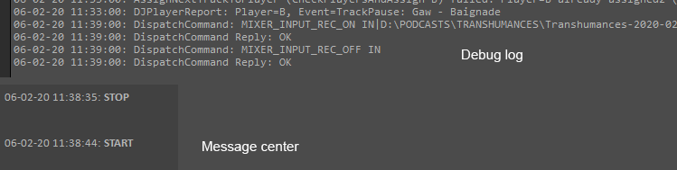

I asked you a few months a ago if it would be possible to add a priority system for multiples reminders that are executed exactly at the same time.
We used it from then but today I noticed in the debug log that sometimes, the priority is not respected (it seems to be a random problem).
Here are the attachments of the problem we encounteer, the priority 0 reminder is executed after the priority 1 reminder.

Posted: 07 Feb 2020 16:13
by jsonio
Hello Bernd,
1- Thank you very much but unfortunately it is still not working... so we tried to add different timings to show the commands in the message center hoping that it would force the order of the commands to be respected but it was unsuccessful.
I'm just thinking about something... maybe it is actually working but the problem is we misunderstood the way the scale of priority is?

Re: Reminder priority randomly not respected
Posted: 07 Feb 2020 20:50
Yes, the start time needs to be changed in the recurring form for recurring items.
You can click on the '?' icon at the very top right of the dialog to get help...
Prio: (Priority)
Defines the order in which reminders are used/executed in case multiple start at exactly the same time (0, 1, 2, 3, ...)!
A reminder starts at exactly the time, if the 'Start Time' AND the 'Show in Advance' value do have the exact same values, resp. result to the exact same effective time.
So yes, it should order it that way (0, than 1, than 2 ...).
But you need to adjust your "Show In Advance" time to the exact same value!
But I guess there might indeed still be an issue in my code...I'll double check!
