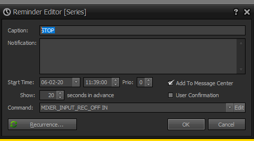

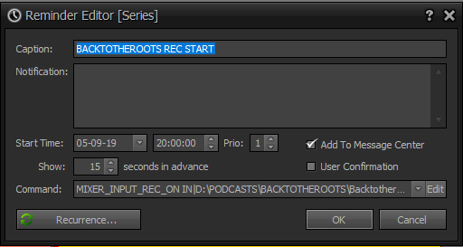

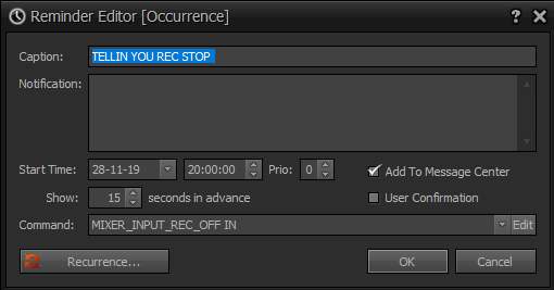

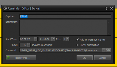

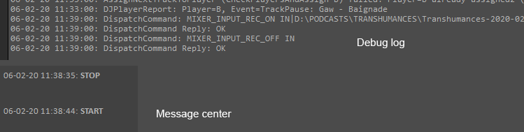

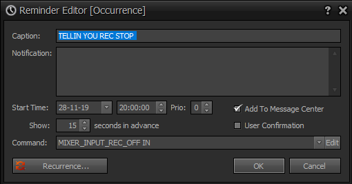

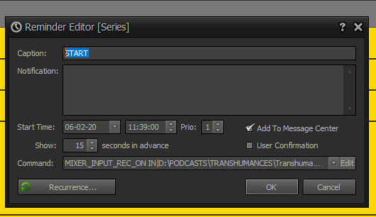

Here are the attachments of the problem we encounteer, the priority 0 reminder is executed after the priority 1 reminder.

The reminder is used to record LIVE broadcasting on the input "IN".
They don't have the same schedule as the automatic PF player (So we can't rely on a programchange event to record them because the program sometimes changes during the LIVE).
i.e. what happens :
6pm START REC IN the LIVE1 > PODCAST1.mp3
8pm STOP REC IN prio:0 ->podcast1.mp3 = exactly 2hours long
+ some weeks (so we need 2 different reminders to be sure it will be stopped if there is no LIVE2)
8pm START REC IN prio:1 the LIVE2 > PODCAST2.mp3
10pm STOP REC IN ->podcast2.mp3 = exactly 2hours long
If I choose 8:00:01 pm or 7:59:59, the podcast will be slightly cut which is not accurate enough for a podcast that is sent later to other radios and rebroacasted.
Maybe then it would be easier for you to include ms, in the reminder time?
Like stop REC at 7:59:59.999 pm
And start REC at 8:00:00.000 pm
Or maybe there is a command that would permit to force to target the thread used to record, like :
6pm START REC IN with THREAD1 the LIVE1 > PODCAST1.mp3
8pm STOP REC IN with THREAD1 ->podcast1.mp3 = exactly 2hours long
8pm START REC IN with THREAD2 the LIVE2 > PODCAST2.mp3
10pm STOP REC IN with THREAD2 ->podcast2.mp3 = exactly 2hours long
In this case, the two threads could be processed exactly at the same time with no matter the priority.
Or maybe there is a command to stop recording by the filename?
Thank you a lot for your help,
Justin

We splitted the commands into 2 reminders because they don't have the same recurrence (the STOP has to happen every week but not the RESTART) .

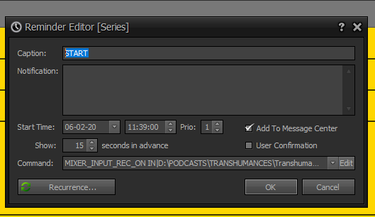

1- Thank you very much but unfortunately it is still not working... so we tried to add different timings to show the commands in the message center hoping that it would force the order of the commands to be respected but it was unsuccessful.
I'm just thinking about something... maybe it is actually working but the problem is we misunderstood the way the scale of priority is?
It this (as we think)
0 highest (execute first)
1 high
2 normal
3 low
4 very low
999 (execute last)
etc.
or the exact opposite
0 lowest (execute last)
1 very low
2 low
3 normal
4 high
999 highest (execute first)
2- For a recurring reminder, when we change the "start time" field, the new time is not taken into account but if we change it in the "recurrence" pannel, the reminder is correctly executed at the new time.
Thank you a lot in advance,
jsonio
Re: Reminder priority randomly not respected
Yes, the start time needs to be changed in the recurring form for recurring items.
You can click on the '?' icon at the very top right of the dialog to get help...
Prio: (Priority)
Defines the order in which reminders are used/executed in case multiple start at exactly the same time (0, 1, 2, 3, ...)!
A reminder starts at exactly the time, if the 'Start Time' AND the 'Show in Advance' value do have the exact same values, resp. result to the exact same effective time.
So yes, it should order it that way (0, than 1, than 2 ...).
But you need to adjust your "Show In Advance" time to the exact same value!
But I guess there might indeed still be an issue in my code...I'll double check!
