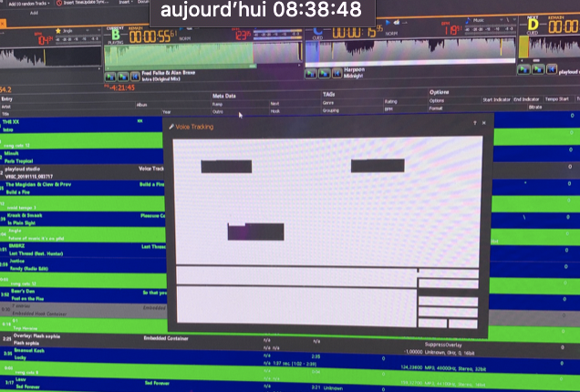

Hi Bernd, here's a strange issue one of our djs experienced several times:
As He's doing his show live, he's recording the end of his show using VT on the same playlist.
Sometimes when he clicks to to record the VT window doesn't load completely.. and stays lie this frozen.
At the same time, the on air track keep playling till its end, then nothing happened and it needs a restart.
As I just had a quick look there's nothing in the error log.
Re: issue while VT
If there is nothing in the Error.log it is not an error within ProppFrexx.
Please take a look to the Windows Event Viewer to see, if you can spot any errors there.
The screen actually looks like the OS/system is running out of resources and as such cannot fully display the window anymore.
This could be a memory issue, a bad graphics driver or simply a too weak system?! Hard to say.
As said, please take a look to the Windows Event Viewer to see, if you can spot anything there.
But this is definitely not a ProppFrexx issue, as else something would have been logged to the Error.log file.
