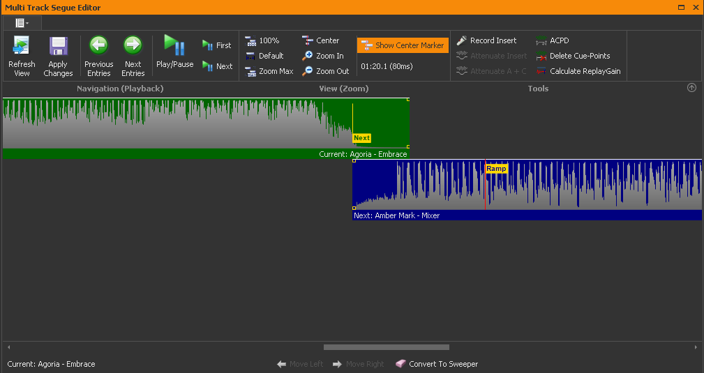

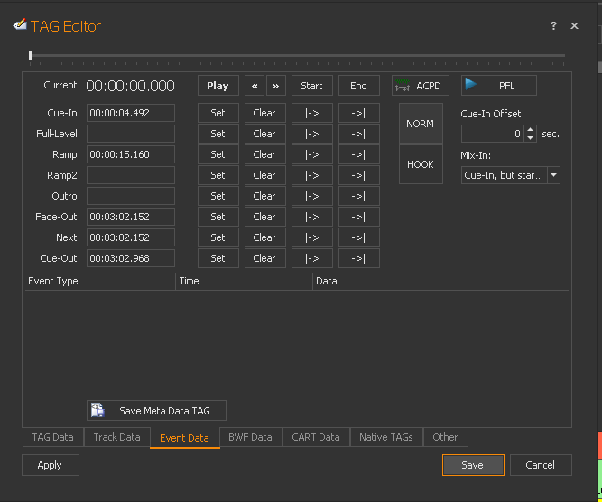

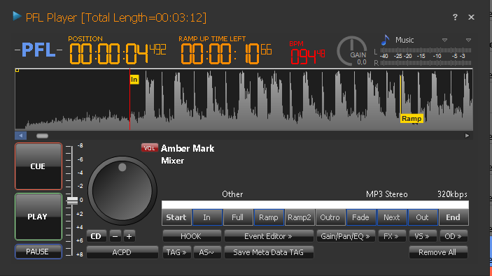

maybe not a bug, but it looks like.
where is the cue point in the segue editor??
and why is the mix point set at "start" and not at "cue in"
Note that it's sometimes impossible to pfl from segue in this particular case (not everytime) but sometimes stop at the end of the previous track then blink

Re: cue in mix but start from begining
You have set the MixIn value for the track to "CueIn, but start from the beginning" - this setting actually causes exactly this behavior!
I.e. the original cue-in position isn't show in the Segue-Editor anymore.

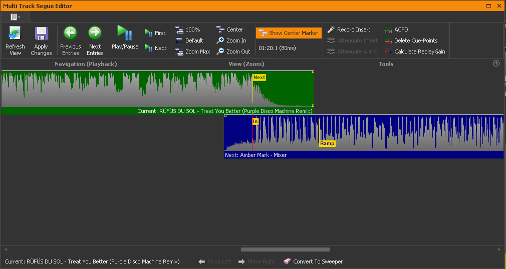

Something is not clear in this option... Here's what I'd like to obtain. but i want to hear the part from start till cue in point.
I want the cue in point of the track aligned to the next of the previous (as it is supposed to be) but i want to hear that little previous part at the start.
This is actually what the "CueIn, but start from beginning" should do - isn't it?

it should but it doesn't.. look at my first post pictures ... you can see that "CueIn, but start from beginning" is selected. then check on the pfl where the cue in point is located. and if you look to the segue editor you can see that the start is aligned with the next (not the cue in)
Ahh, now I see it. It actually plays CORRECTLY thru the DJ Players, but you are right, the display in the Segue-Editor is not correctly adjusted. This is just a initial display issue in the segue editor, which will be corrected in the next version!
