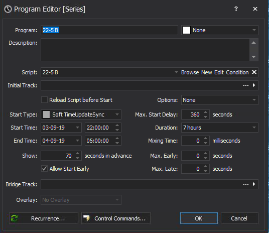

The background playlist (from 22:00 to 5:00) is configured with soft TimeUpdate Sync.
The thing is I used the exact same config for all the others overlay shows and have no troubles before...
The config of the the active program and the overlay are in attachment. Maybe I made something strange ?

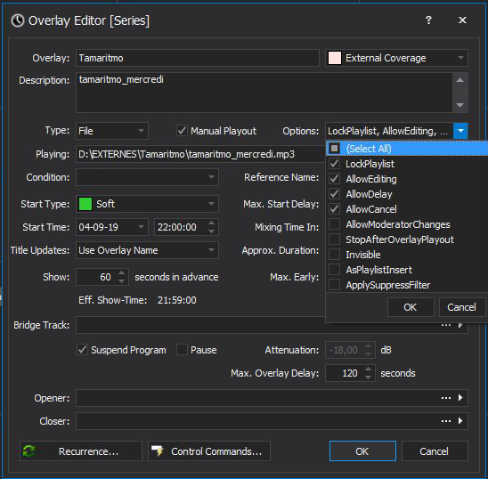

Why did you select 'Manual Playout' with that overlay?

We use manual playout because on some show, the previous live show can finish a little later.
So this prevent the overlay to be cancelled this option is used.
Is this option the reason of the playlist not restarting ?

Yes, correct, 'Manual Playout' also means, that it should end manually, ie. the subsequent program should be started manually.
I.e. I suggest, that you switch this option off.
As in your case (due to the 'Soft' start type) the first (any in your case only) track will regardless be started automatically in the overlay.

Ok then i will correct these overlays like this way
I imagine i can achieve the same result with setting the max delay time to like 15min ?
So the overlay will wait max 15min before being cancelled ?

For safety i added OnOverlaystopped : OVERLAY_DOCANCEL
So, in theory, this won't happen again.
I tried to use the overlay delay setting to force the element to wait until the end of the current live show, but that doesn't worked for me.
The overlay wait the "Show in advance" time + few seconds then cancel itself... It only wait if i use the manual play option (and soft start).

Where and with which events do you set these commands.
Note, that AutoPlay is turned off automatically when the Overlay is used! Using the PLS_CURRENT_AUTOPLAY_OFF command in parallel might also cause issues.
