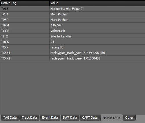

Now i recently discovered a problem that PF does not read the Grouping tags in my mp3 files.
In the PF TAG Editor i don't see the Grouping tag in my mp3 files within the Native TAGs tab.

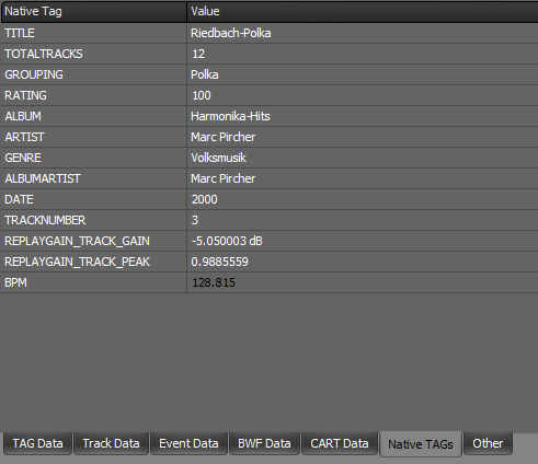

For all of my FLAC files, i also tagged with mp3tag, it works like a charm. The tag is also shown in the Native TAGs tab.
I see differences in the Native Tag descriptions for FLAC and MP3 files. In MP3 i see the Native Tag discription as abbreviations.

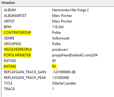

When i use the grouping tag inside the PF TAG Editor i see (besides some extra unusefull created tags :( ) a new created "Contentgroup" in mp3tag, even when i first delete the "Grouping" tag in mp3tag. However, i do not see the new tag in the Native TAGs tab, even after a rescan of my mp3 files in my folder based media library and restart of Proppfrexx. It seems like PF does not recognize the Grouping tag in mp3 files.

Some screenshots i made:
- 1st MP3 Native TAGs info
- 2nd FLAC Native TAGs info
- 3rd same MP3 but mp3tag info
Kind regards,
Henk

Leaves me with the question, why can't i also see the TIT1, TT1 information in the Native TAGs tab area when i use the Grouping tag within the PF TAG Editor?
I have used the save button so it should been saved to the mp3 file. When i perform a new (re)read of the saved tag, i would expect at least to see the new created Grouping tag in the Native TAGs overview. But it isn't.
So it seems PF is not storing / reading the Grouping Tag in the TIT1 frame at a right way either or not all tags are shown as Native TAGs.

MP3TAG make use of the GRP1 field for the Grouping tag with ID3v2.3 and TIT1 for the Contentgroup tag according their help page at https://help.mp3tag.de/main_tags.html
So it seems we have two ways to place extra information with our media whereby Grouping (GRP1) is the most common used for extra additional Genre info as far as i know and we have Contentgroup (TIT1), generally used for Grouping for MP4 / Work name for MP3. After some tests i can see that PF writes his "Grouping" tag as a "TIT1 Contentgroup" tag in ID3v2.3. Thus mp3tag reads the right stored tag by PF. And for FLAC, changes in the Grouping tag is neatly saved as "GRP1 Grouping" tag. PF writes the same Grouping content in the editor at multiple fields for different types of media? As far as i can see, this is not logical and really confusing.
