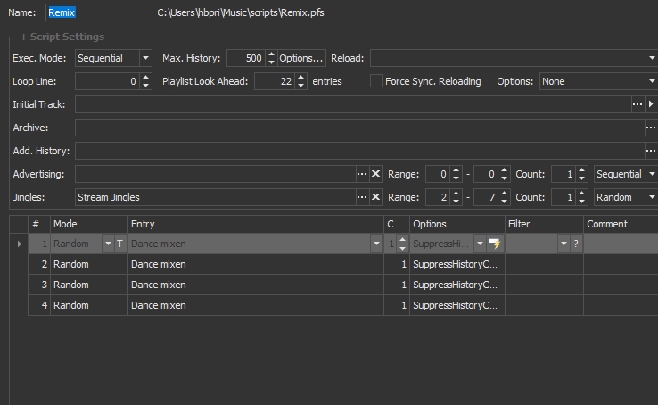

Re: Few questions regarding scripts
made a screenshot .. it's realy easy..
