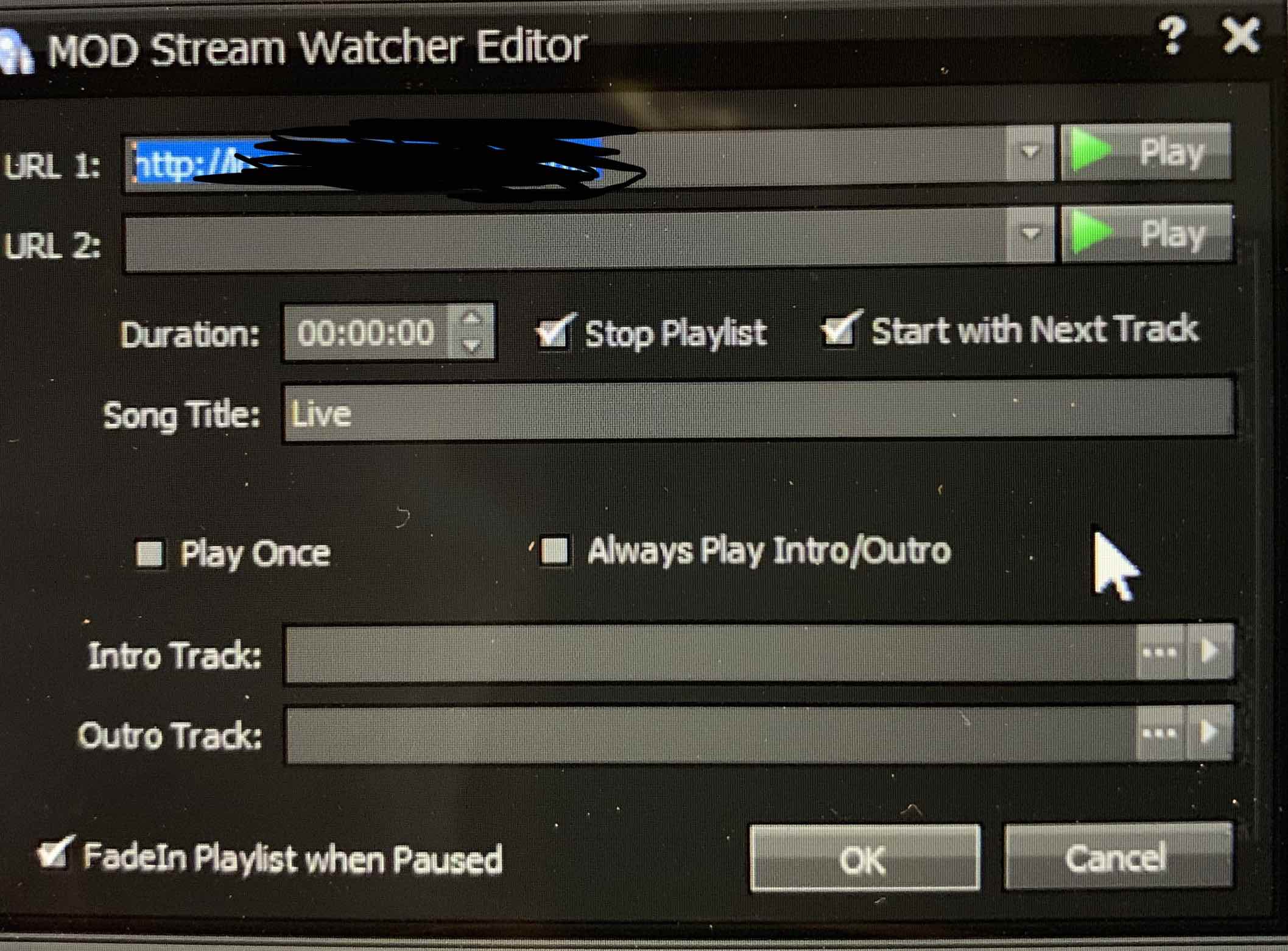

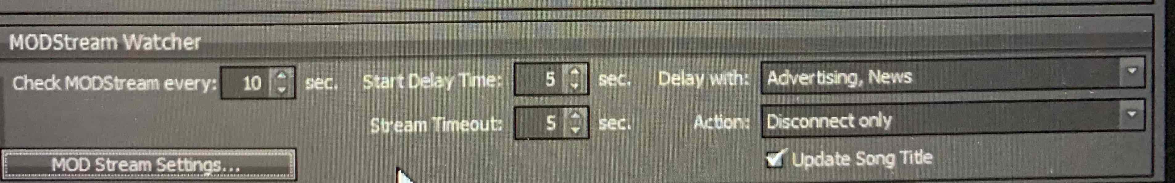

We use the modstream for the live broadcasts. If, for example, the internet connection is lost at the live station, the playlist must start playing. if the modstream is stable again, it must go live again after a complete song from the playlist.
We now often have the problem that the playlist plays parts of a number of songs, or even the playlist and the modstream play together. But sometimes it goes well.
Can you indicate where this goes wrong and what we can do about it?
I have added 2 photos of the settings.

If it happens again, please turn on the 'Debug Logging' (section More Stuff) and then reproduce the issue.
After that, deactivate the 'Debug Logging' and then send me the generated log file called 'Debug_.....log' contained in the AppUserData folder.

The playlist is running because the live station is buffering. The live station is already back, but not live again. if you then want to temporarily switch off the modstream because the live station is not stable, the playlist switches to the next track.
