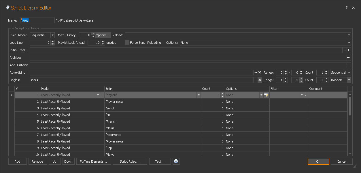

Jingles are in automatic mode.
About the overlays.. As We use a lot RVT and VT, overlays are generated from specific scripts/and planned in the overlay scheduler
then in the O.Sched. we force those to be embeded to got those inserted at their final location in the playlist (then we can do some RVT with a quiet precise time indication.
I won't be able to send more before this afternoon
Re: rules for embeded overlays
Ok, please provide more info later on, as I don't know what do you mean by 'automatic mode'.
Also, when you say you use RVT/VT - this sounds, that overlays are planned in the Overlay Scheduler and are resolved dynamically? - OR do you plan them as part of your script (in dedicated script-lines)?
Post by moogwill »
here's a screen cap
