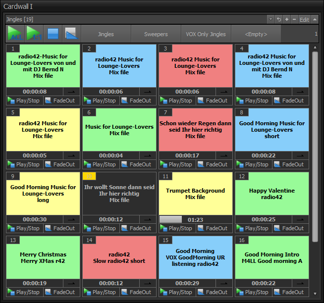

ProppFrexx comes with 2 independent cartwalls:

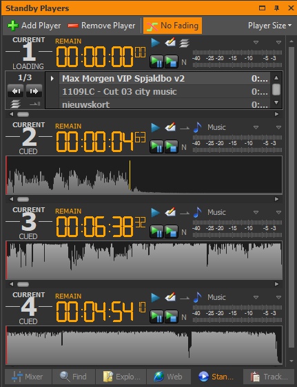

And also an additional list of so called Standby Players:

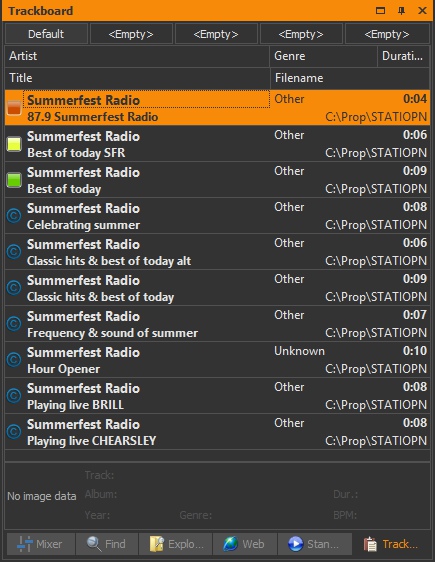

As well as a Trackboard:

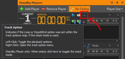

How to set the standby player in stacked mode?
Re: Jingleplayers like Omniplayer, Dalet and Aeronstudio
Just click on the little stack icon in the middle top (next to the PFL and Tag button).

There is no stacked icon.
It is the third small Icon at the top middle.
To left you’ll see the PFL icon, next to it is the 2nd icon which is TAG icon and finally at the right there is a stack icon, which toggles the standby player between the normal single track mode (arrow symbol) and the stack or mini playlist mode (3 papers symbol).
So just click on this 3rd icon to toggle the mode.

I click on that symbol but the stack symbol is not there.
The Standby-Player's Player-Size must NOT be "Small (No WaveForm)" or "Medium (No WaveForm)", e.g. it must be "Small" or "Medium" or "Full".
You then click on this icon as shown above.
And get the player into stack mode:

What are the stand by players used for exactly?
Just alternative players outside a playlists.
