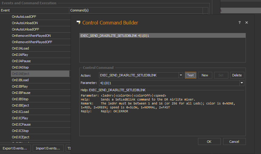

Dear forum members, I am playing with the d & r airlite including proppfrexx. Now I wonder how I can turn on the buttons of the control function of the airlite.
Posts: 9065
Re: D&R Airlite Control button light
Use the two control-commands EXEC_SEND_DRAIRENCE_SETLED or EXEC_SEND_DRAIRENCE_SETLEDBLINK
Examples can be found here: viewtopic.php?f=9&t=1804
and here: viewtopic.php?f=9&t=1859

the lednummer is between 1 and 16, so that are the cardwall buttons
What i want is the fader-swithces to close at the end of the track ( when eject ) so it turns back to red

Hi, have you imported the events file properly? It´s all defined.

meisterpropper wrote: 11 Apr 2020 12:15 Hi, have you imported the events file properly? It´s all defined.
eh..no..how do i do that ?
meisterpropper
Posts: 86
Joined: 03 Aug 2012 09:36
Post by meisterpropper »
Official download: https://github.com/benhartwich/proppfre ... r/airlite1
Settings => Events / Commands => Import
Posts: 9065
Here is a YouTube Video related to it: https://www.youtube.com/watch?v=IfZiGkI ... e=youtu.be
And here is the full instruction files by Benjamin Hardwich: https://github.com/benhartwich/proppfrexx-remote
