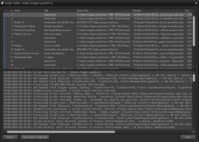

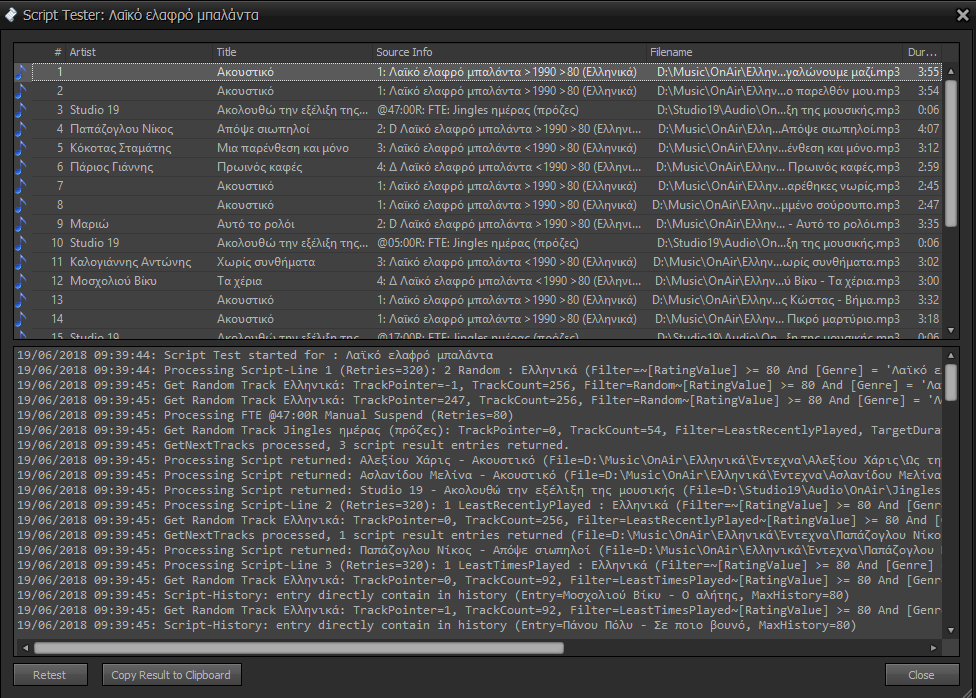

Now I notice that there is one more problem here:
The artist / title do not show on some records:
For the title it shows a genre that does not match to the script line.

I believe it's bug because it always happens on the first script line.
Re: Test script errors
I don't know, if it is a bug, as I cannot reproduce it here! I more believe it might be an issue in your media lib.
Maybe it is because of being a track having such meta data tag corruption I was talking before?!
So,
please send me the related physical audio tracks associated to your 1st script-line and how you used them in a media library (is it a playlist or folder based one)?
Well, looking at your script, you have explicitly set the song title of the first script-line to be "Ακουστικό" !
This is the reason, why you ONLY see this entry, but not the effective "Artist - Title" of the real underlying/returned audio track.
So please remove the explicit 'Song Title' from the first script-line and you will again see the full Artist and Title.
