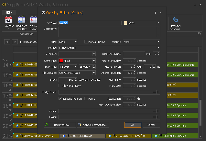

As You might remember from previous messages we use the overlay player to play out a commercial block + news block + commercial block at every hour where the news block is setup for a fixed starttime at every HH:00.
Also i did setup the Overlay Player to show 9 minutes in advance so the DJ can check the countdown timer to see how long it takes for the overlay to start playing.
Two things that our users keep asking for are:
1. Show the correct countdown time
2. Let the Overlay player start automatically
A bit more info on 1:

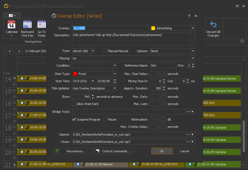

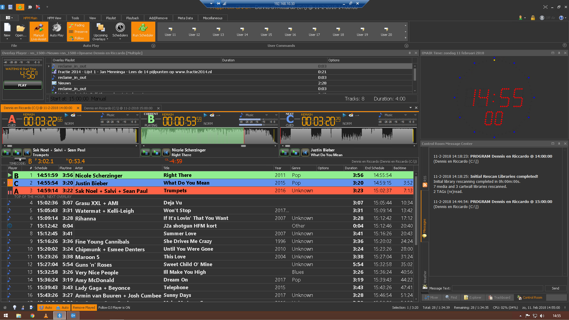

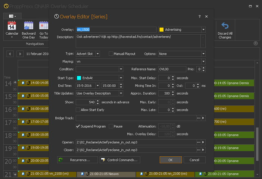

As you can see in the Overlay_Countdown screenshot (attachment) the overlay is set to start manually at 15:00:00 and the countdown timer is counting down to 15:00:00. But there is a commercial block in front of the news consisting of 3 items for a total of 27 seconds. Therefore the countdown should really be counting down to 14:59:33. I think the value of the countdown timer should consider all the 'EndsAt' items that are to be played before the fixed items.
Wish 2: It would be nice to have a setting in the general settings where i can set the Overlay Player to start automatically even if the system is in 'Manual Live-Assist' mode. But for this option to be practical first the value of the Countdown Timer should be showing the correct value. In that case the DJ only has to observe the countdown timer and as it approaches the 0 he should close his faders to let the Overlay Player do its work.

Then there must be something wrong, because the Overlay player does not start automatically. In the accompanying screenshots for the overlay entries we have at 15:00 on sunday you can see that the 'Manual Playout' option is NOT used.
If i push the PLAY button of the overlay player it counts down again (A Fade Out time perhaps?) and then i have to push the PLAY button again to actually start the first overlay item.
