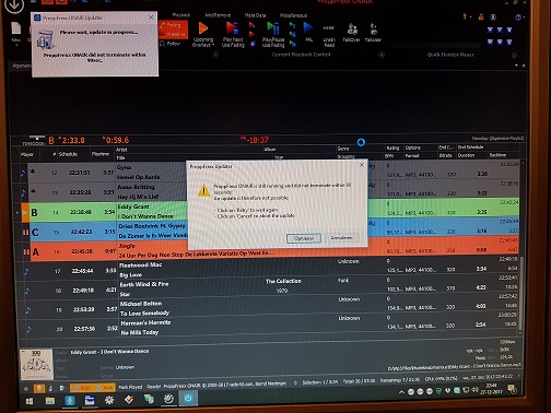

Hi forum members, I run into a problem. I get in my screen that there is an update of ProppFrexx. I want to install this but he gives an error during the installation. He makes no mistake during the download. Does anyone know what to do?

The issue is due because ProppFrexx does not close itself after 90sec.
In most cases this is because you are using a VST DSP plugin which does not terminate itself gracefully and is probably hanging.
Are you using a VST plugin, if yes try without it or try to update it to a newer version (I for example recall, that an older version of StereoTool had this issue).
Re: ProppFrexx updater
If it was not a VST, then some System driver was not able to stop the system. And as ProppFrwxx only needs to free the used sound card session, I can only assume, that this is blocking PF from terminating.
If possible, try to see, if you can get a newer version of your sound card driver.

if you close PF manually, the update may start from itself?

Thanks for your reply, but I do not use a vts plugin. I use steretool stand alone. I solved the problem by removing proppfrexx from my PC and installing it again. now I have the new version.
