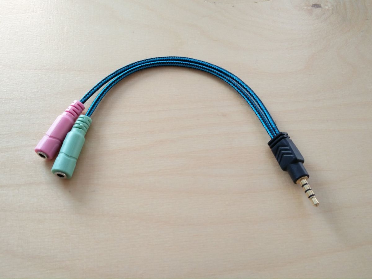

Thanks. I´ve used the following cable (see attached image). But this doesn´t work. My smartphone uses the internal microphone. I don´t get it, what I´m doing wrong.

Ok, you need to take different steps to find out, where the error is...
First: Can you record the audio with the phones built in voice recorder? (most Android phones has some kind of voice/memo recorder)
Second: Try another phone, or an iPhone (so we can find where the error is)

Yes, three rings doesn´t work at all. I´ve ordered a usb c to mini jack input cable. perhaps this could work, but I don´t think so. With an iPhone there´s no problem routing external audio to facebook?
Re: Facebook Live Audio
Note, that your mini jack has four rings.
Have you tried a standard mini jack with only 3 rings?
