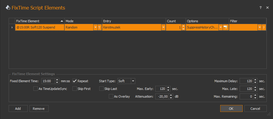

Good evening Bernd,
As i mentioned in another topic i did setup an FTE in our nonstop scripts to play X-mas songs.
On the screencapture below you can see that i did setup the FTE to repeat at 15 minutes which should result in about 3 X-mas tracks every hour. I also suppressed the history check to prevent exclusions on same titles etc.
But as you can see in the playlist logfile below only at 2016-12-09 21:13:43 a X-mas song is scheduled, but no more after that. And it's the same for every hour.
2016-12-09 21:03:07, "ns_avond @ 9-12-2016 21:00:00", "Nonstop Avond (Regular Show)", "ns_avond [ns_avond.pfs]"

It looks like the repeat checkmark is not working as it should. Can you check this please?

Re: FTE not repeating...?
No, that is a misunderstanding!
'Repeat' means it repeats every hour at the given time! I.e. Every hour at :15:00!
So it does not mean every 15 minutes.
In your case you would need to setup 3 FTEs.
Post by Havenstad FM »
Allright, my bad, i added some FTE's and it works as you explained.
Issue closed.
