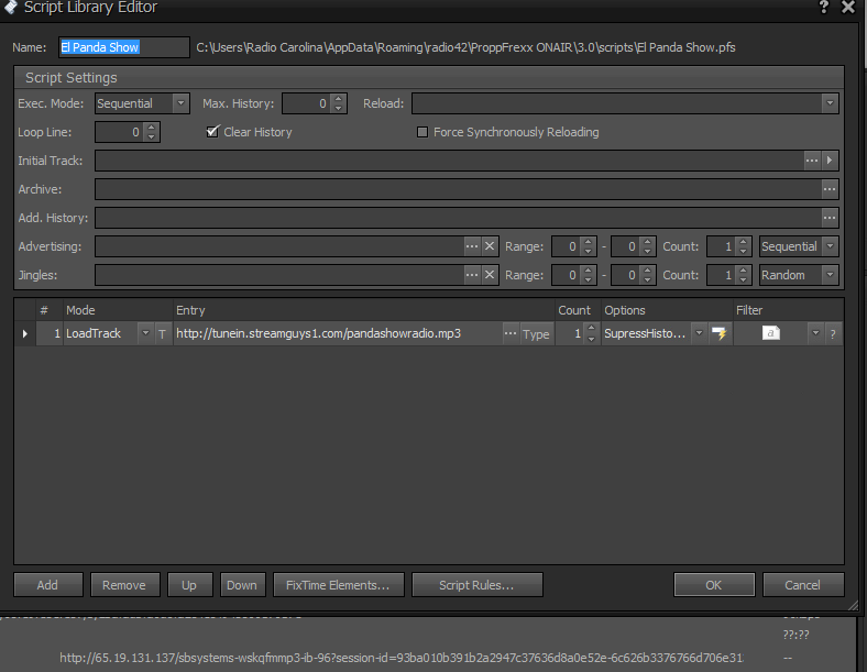

Re: Add stream to scheduler
thanks for you answer. I appreciate you help but is the first time that I use this software and I feel its complicate because the way to explain is not clear, please can you be more specific and show me the way to run and programing at schedule a streaming url, I have other radio and before we buy other ones I would like to understand how this work if no we going to look for other software thanks for you help. maybe is simple for you but I fallow you information and is not working, when I rung the schedule automatic insert 3 or more track with same url and don't let me play the over lays. I attached two file that you can see. thanks
- 02.PNG (55.64 KiB) Viewed 12815 times
- 01.PNG (35.66 KiB) Viewed 12815 times

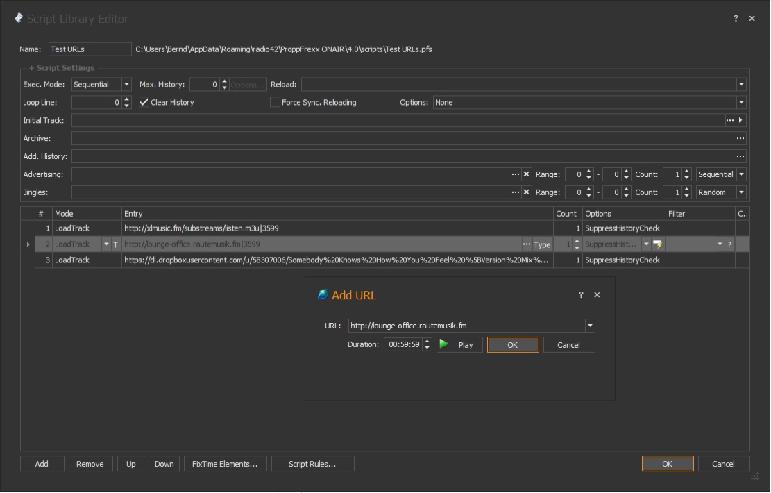

Here is a screenshot showing a single script, with multiple script-lines, each scheduling a different URLs:
(as you also already posed a screen-shot, I assume you know where to find this)Hold down the CTRL-key when clicking on the '...' button at the end of the 'Entry' script-line cell (next to the 'Type' button) to invoke the shown 'Add URL' dialog. Note, that for streaming URLs you can/should specify a maximum play length/duration - as else (if the Duration is set to 00:00:00) the URL would play unlimited resp. til its natural end - which is for streaming URLs typically not desired.
(the number at the end of the 'Entry' value denotes the number of seconds to play the entry)
To add additional script-lines, just press the 'Add' button at the end of dialog.
Also press the '?' icon at the very top right to get a detailed help about all options...

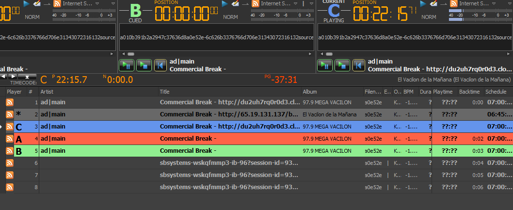

OK well I would like to have a contact number and explain better. but this is the problems:
I have my radio station at South Carolina but I want to programming an specific show from other radio using a url streaming from other radio. So this is the stream url that I would like to programming at schedule they may show Monday to Friday am to 11 am
this is the url: http://tunein.streamguys1.com/pandashowradio.mp3 and basicaly I would like to know fow i can programing this url on schedule to automatic play Monday to Friday 8am to 11am.
I did the regular step but when the schedule is running for some reason automatic load 3 or more time the same url at player A-B-C like the previous picture.
I kow maybe is to much to ask but please can you try to programin and take a snapshot and share with me maybe im doing wrong please, i thinks this is the best program

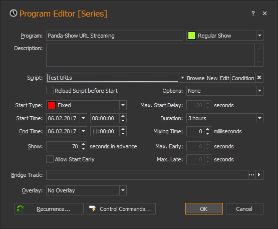

Instead of a video I decided to publish a small walkthrough with images, as there are a few things to notice with scheduling streaming URLs.
The major difference when scheduling Streaming URLs instead of audio files is:
- a streaming URL has no defined lenght - i.e. it would plays indefinitely (unless it terminates prematurely)
- a streaming URL might end prematurely (e.g. in case of a network error or the server stops)
- a streaming URL has no defined start; nor any cue-points; thus no real 'Soft' transition to a next program is possible

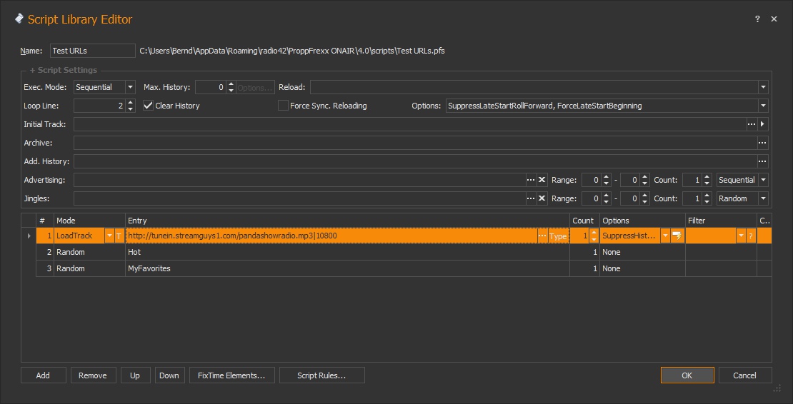

Your requirement was now to schedule a certain URL (http://tunein.streamguys1.com/pandashowradio.mp3) ever Monday to Friday between 8am and 11am - which is 3 hours.
When we consider the above, a script to schedule this certain URL might look like this:There are a few things set in the script which are important to notice...
The demo script consists of 3 script-lines. Only the first one contains the URL entry (LoadTrack = http://tunein.streamguys1.com/pandashowradio.mp3|10800).
Remember to hold the CTRL key and click on the '...' button as explained in my previous post to define a URL entry here!
Note the number 10800 at the end of the script-line entry!
This defines the number of seconds to play the URL (see above, a streaming URL has no natural end, so we need to define it here).
10800 seconds are exactly 3 hours.
I then have defined some options with this script-line : SuppressHistoryCheck, SuppressAddHistory, KeepStreamLoading, KeepStreamAlive
The first two options ensure, that the URL entry is not checked and added against our history - as otherwise it might be rejected - meaning for a URL it makes no sense to place or check it against any history.
The other two options (KeepStreamLoading, KeepStreamAlive) will ensure, that a reconnect is tried in case the stream is temporarily not available when loaded to a DJ Player.
The other sub-sequent script-lines are your emergency script lines. Meaning, the first (above) script-line will already play the URL for 3 hours - so if all is good, only this entry will effectively be played during your 3 hour program.
But the other script-lines are needed as explained above.
The global script LoopLine value is set to 2:
The LoopLine parameter defines, that in case a script is looped (as more tracks are queried by the playlist in advance), it will NOT start with the first line again; but with script line number 2.
Here I used some local media libraries which contain some music tracks. In your case you should also create at least one media library with emergency music tracks.
As I explained above, when a new program starts, its playlist is scheduled with tracks from the script, so that all 3 DJ Players are loaded with tracks and N number of unplayed tracks are in your playlist. E.g. 6 tracks in total.
In our case (using the above script), this would now mean:
DJ Player A is loaded with the URL stream.
DJ Player B is loaded with a random track out of a media lib 'Hot'.
DJ Player C is loaded with a random track out of a media lib 'Favorites'.
Plus the playlist will contain a few more unplayed entries also with tracks out of 'Hot' and 'Favorites'.
Plus I defined the global script options SuppressLateStartRollForward, ForceLateStartBeginning
These options just ensure, that in case you manually start your program late (e.g. because you just rebooted the PC) the script will always start with the first script line and never roll-forward in time.
That's it for the script. Now lets take a look to the related Program Scheduler entry:
(open the Program Scheduler from the 'Scheduler' ribbon underneath 'Schedulers')... then navigate to the desired time and right-click and select 'New Recurring Program..-'.

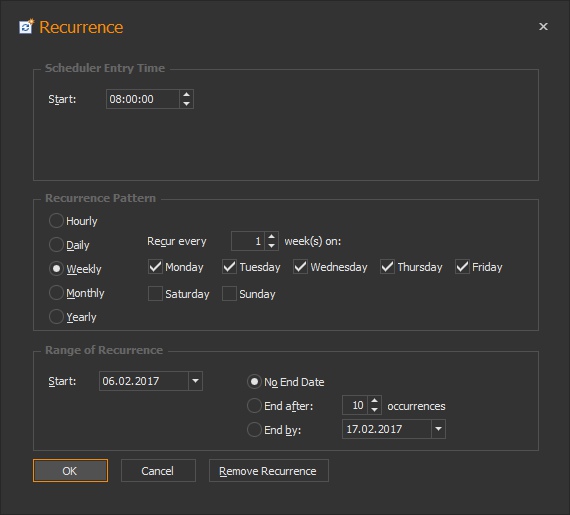

At first you specify your recurrence (Monday til Friday at 8am):Start is at 08:00:00
The pattern is Weekly recur every 1 week at Monday, Tuesday, Wednesday, Thursday and Friday; with No End Date.
Click OK and in the next dialog you define the actual Program Scheduler entry, e.g. like this: Note, that for Script' you should select the script lib we just created above.
We are using a 'Fixed' start type in this example, meaning we start exactly at 08:00:00 (8am) and set the End Time to 11:00:00 (11am) - which also gives us a total duration of 3 hours - just like for the URL script-line.
That's it almost. The only option we might play with is the 'Mixing Time' value - see the '?' help for details.
Click OK to save.
