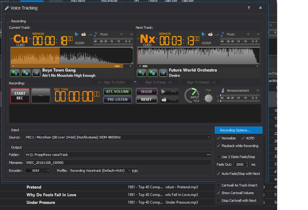

- The level diffrence is huge, is there way way to normalize them? I did add Normalize in recording options, are all other record options oké?
Are these settings oké?
-> What level difference do you mean? Between 2 tracks (Cu and Nx) or between your tracks and your voice recording?
I assume, that this is due to your sound card setup/environment. If your voice recording is too low, increase your input signal from the microphone!

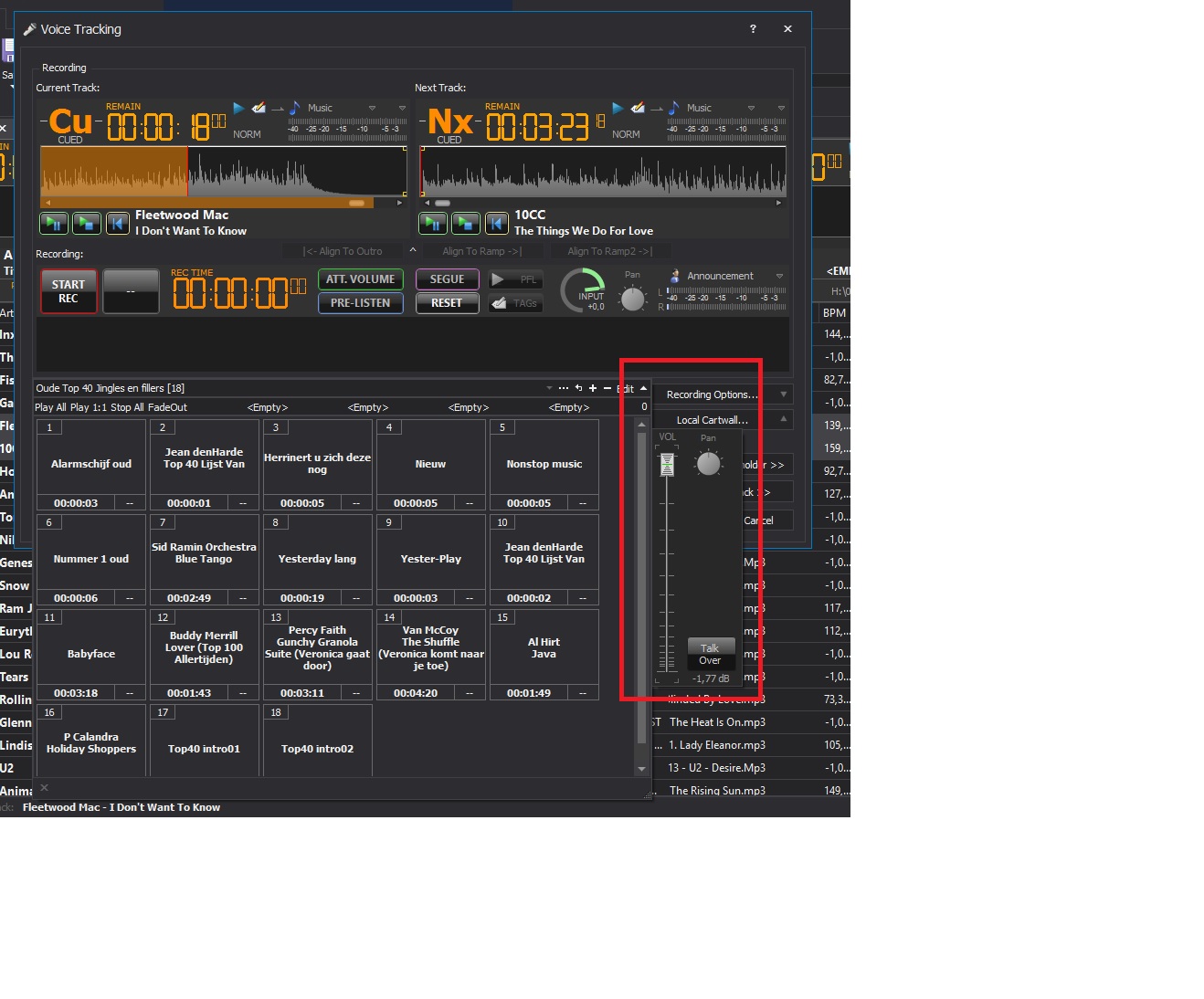

when people start talking, the music is often to loud in consideration to the talk. i can't find something like "talkover". ( see pic)
When VT is started, the music start's its normal playback, so you can simply adjust your headphone.
Once you recorded your voice over, you can use the build-in "Segue Editor" or click on the "Att. Volume" button to attenuate the surrounded tracks according to your voice track.
Click on the '?' icon at the top right to get the info for all options displayed.
