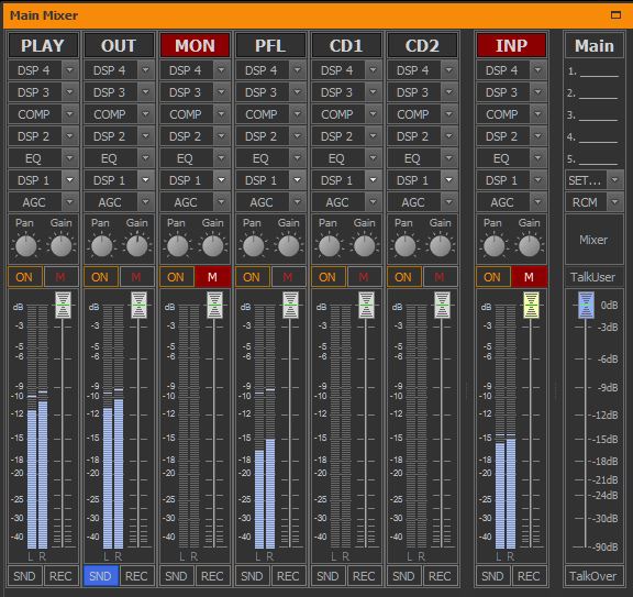

1 – Main Mixer (pictures attached):
MON, CD1 and CD2 cursors not moving.
The external CD1 and CD2 players connected to the mixer are working and audible online. Do I need to have them on Main Mixer panel or just remove it?

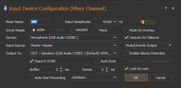

2 – MIC:
with no sound using the “talkuser/talkover” function. The mixer has also a talkover knob but no MIC sound at all. Please take a look to the INP image.

Everything which is directly connected to the mixer isn't needed in ProppFrexx, as the mixer controls these external devices (and not ProppFrexx). As such, I assume you do not need the CD1 and CD2 mixer channels!
The same might (almost) also be true for the INP channel. I assume you directly connect the microphone(s) to your mixer, as such, in order to use them, you would not need any INP channel in ProppFrexx, as all is handled by the mixer in the case as well. Depending on what the recording USB device in the Behringer delivers (e.g. the master output signal or the Mic signal only)? You might still want to use an INP mixer channel for streaming or recording.
BUT... do NOT set any value for 'Output To:' !, as again the routing is handled already by the mixer. If you would route the INP signal back to an output channel, you might create a bad feedback loop! So leave Output To:' for your INP channel empty!

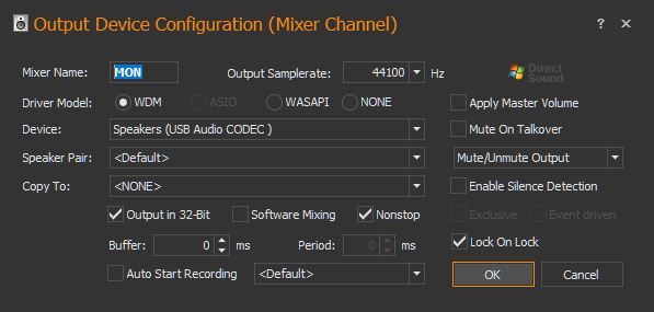

1 - MON is in Main Mixer by default after the configuration, but the cursor is not moving, this is the first problem. Can I remove this MON from panel?
CD1 and CD2 are connected to the mixer and working and I will follow your instructions. I removed CD1 and CD2 from Main Mixer. Working, without any problem.

3 - Output To… for your INP channel is already empty.
(note: I configured the mixer on PFOA using - Tools/Mixer Setup Wizard/5. External Mixer External Microphones (Complex)

What do you mean by cursor - the level meters - it seems you might have simply muted it - see the red 'M'!
Re: Behringer DX2000USB Pro Mixer
Yes, level meters. Now are unmuted, but nothing happens!
And is anything to the MON channel routeted?
e.g. any player or another mixer channel?
Nothing routed to the MON channel.

But this is a different story. Before you said, that at the MON channel the level meters are not moving.
So I assume this is normal, as if nothing (no signal) is routed to it, they are of course not moving.

Or do you mean you cannot hear the MIC signal in your ProppFrexx streaming?
If that is the case, just see above:
I don't know what mixer channel you are using today for streaming; but I assume it is just the OUT channel?
If that is the case, note, that if you want to setup ProppFrexx for streaming the master sum signal of your mixer; you must create a mixer input channel and connect the output of your Behringer to your soundcard input channel - e.g. use the INP channel.
If the Behringer offers with its USB soundcard a master output signal - then use this directly with your INP channel.
And in your streaming setup then use this INP channel !

1- Now I understand that I do not need the MON channel. As I told you this was generated by default on Main Mixer during the configuration on PFOA using - Tools/Mixer Setup Wizard/5. External Mixer External Microphones (Complex). This is solved.
