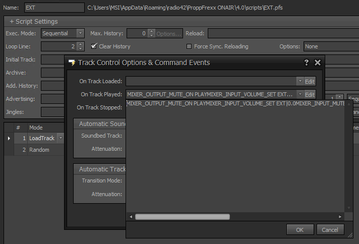

Everytime I restart PF, my control command on a track get corrupted :
PF 2016-06-01 EOL.PNG (47.6 KiB) Viewed 12606 times
The end of line is removed so I have to re-edit it manually to fix it. Could you take a look?
Thanks

I am talking about the Track Control Command Event on the 1st line of my script :
MIXER_OUTPUT_MUTE_ON PLAY
MIXER_INPUT_VOLUME_SET EXT|0.0
MIXER_INPUT_MUTE_OFF EXT
MIXER_INPUT_VOLUME_SLIDE EXT|1.0
was renamed to : MIXER_OUTPUT_MUTE_ON PLAYMIXER_INPUT_VOLUME_SET EXT|0.0MIXER_INPUT_MUTE_OFF EXTMIXER_INPUT_VOLUME_SLIDE EXT|1.0
so the commands doesn't work.

Ahh, sorry you are in the Script-Editor. I'll take a look...
Re: EOL Problem on control commands after restart
A new v4.0.1.33-beta is available which fixes your issue!
So "Check for Beta-Versions..."
