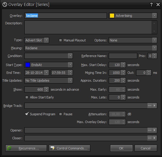

We want to use the 'Max late' in the overlay setting so if a songs duration is less than 120 seconds it wil not be cut off by the overlay.
We use combined overlays,
This is our setting of the first overlay:

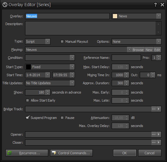

And this is the second:
overlay 2.jpg (70.05 KiB) Viewed 5723 times

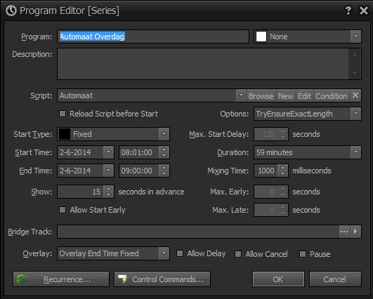

And this is the setting of a program:
overlay 1.jpg (69.87 KiB) Viewed 5723 times
What do I need to change to get the max late working?
Greetz Jesper

So which overlay should have the 'Max. Late' option'?
In your case, where you try to combining multiple overlays in parallel with different and conflicting Start Types, this would only make sense (to me), if you set the 'Start Type' of all overlays to 'Soft' and then make sure to specify the exact same start time and show in advance time for all overlays.

The first overlay should have the max late option.
As long as the first one doesn't start the second does neither, right?
But if you have more overlays set it will always uses the settings of the first one, right? Such as; mixing time, max late?
But what if I change the second overlay to: soft
So first one: EndsAt, max delay:120 and max late:0
second one: Soft, max delay: 120 and max late: 0
Will it work?
And what about the program setting? Need that to be set at Soft as well?
Re: Max late overlay
Yes, in your case I would set all to Soft - incl. the Program.
