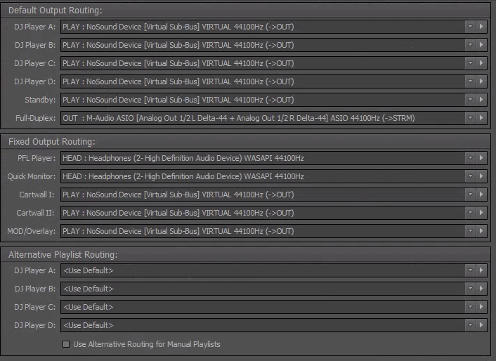

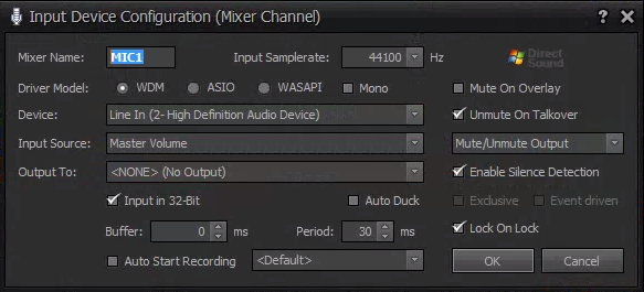

No, and here it actually does... what driver model are you using? And what is the routing of that mixer input channel... so that I can test that here.

Re: Save mixer channel ON OFF state
Oh yes, there is still a small issue with WDM input devices, which I need to handle slightly different.
I'll update that in the next release!
A new v4.0.1.30-beta is already available, which should fix the issue.
