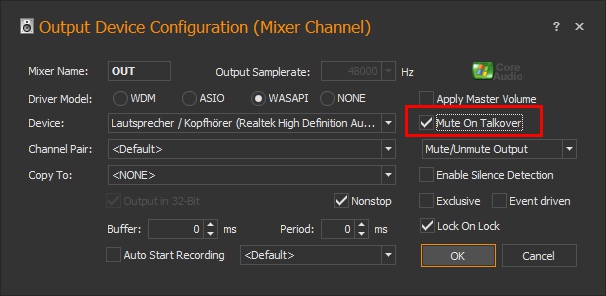

For Mixer Output Channels (which should be muted automatically) open the configuration dialog (double-click on the mixer name) and make sure the 'Mute on Talkover' option is selected:

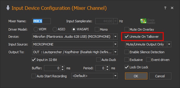

For Mixer Input Channels (which should be un-muted automatically) open the configuration dialog (double-click on the mixer name) and make sure the 'Unmute on Talkover' option is selected:

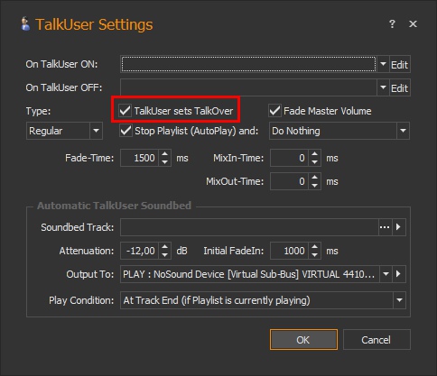

For the Talk-User functionality, also make sure, that you selected the 'TalkUser sets TalkOver' option (the TalkOver function is just about evaluating the above mentioned automatic muting/unmuting of mixer channels).
To invoke the Talk User Configuraiton, e.g. click on the small arrow underneath the TalkUser main ribbon tab icon:

It seems that I was sleeping! Sorry!
Just the Mute On Talkover in the Output Device Configuration was not checked, by my mistake! Now is working.
Once more thank you for your attention, Bernd.
