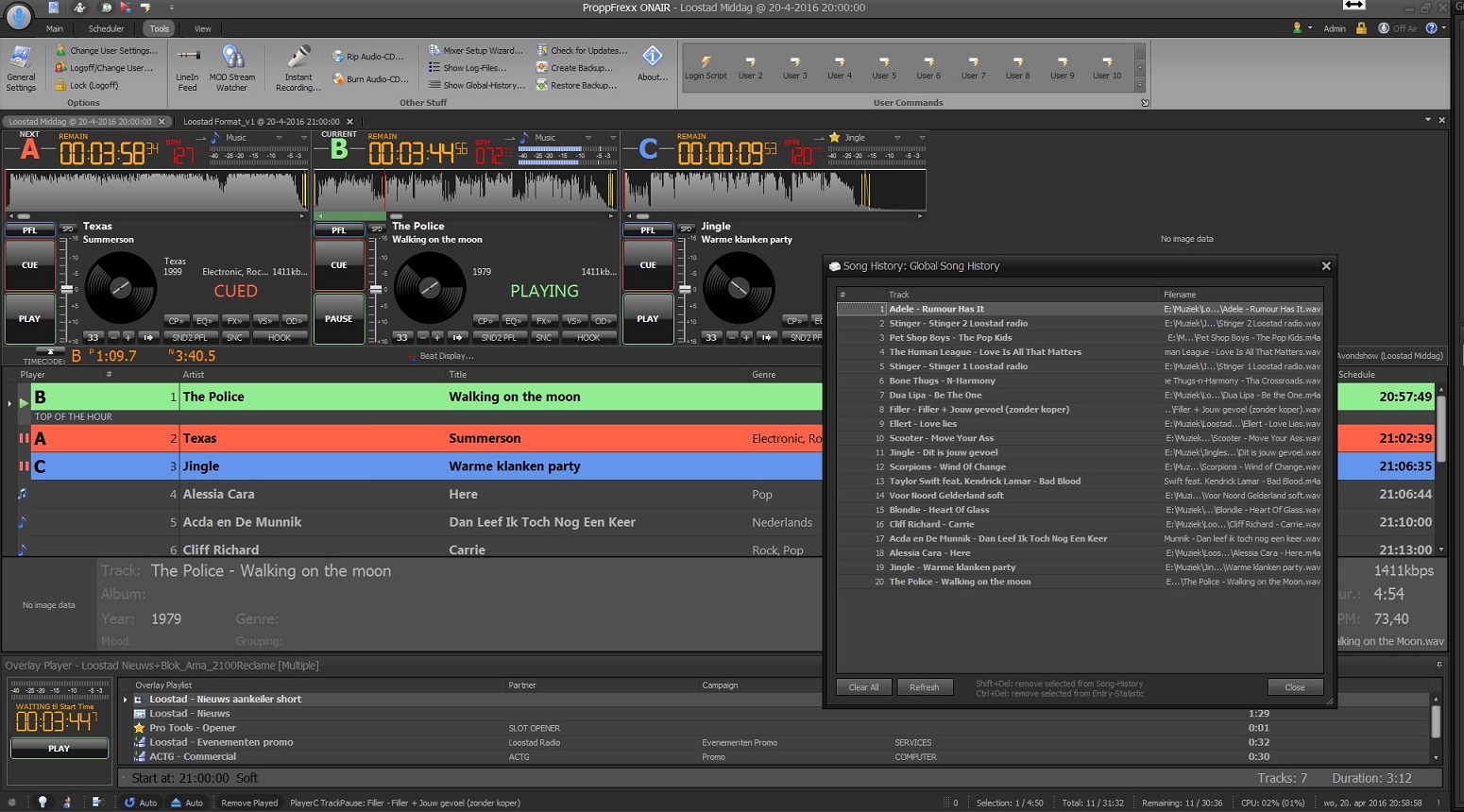

i think there is a bug into the song history.
PFOA put the songs into the history even if they don't get played. the top of the hour is already visible so the song under won't be played but are written in the global song history. here you see the new playlist for the next hour and all the files are in the global song history.
can the history of the songs when they are realy played other wise he skips songs i never hear but are in the song history.

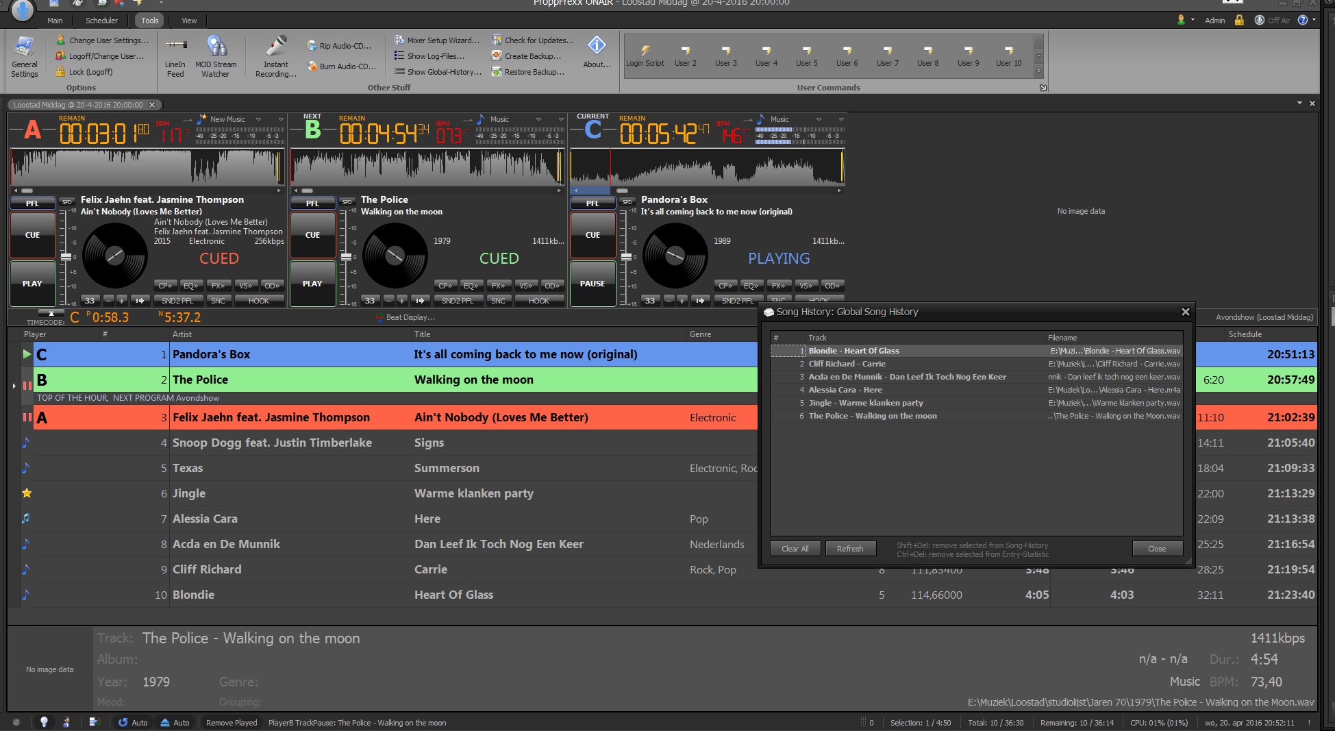

Whenever a track is scheduled to a playlist (no matter, if it might be played or not - as this is not known yet) will at that time (the time it is scheduled) be placed into the history - so yes, this will be ahead of its actual playtime, in advance.
This is by design and correct, as otherwise, other tracks to be scheduled might not be checked accordingly and might result in duplicates.
However, once a scheduled playlist is closed and a new program is starting a new playlist, any un-played tracks of that previous playlist will be removed from the history again.
Take a look to your last screen-shot: here you'll see, that there is no entry anymore for 'R.E.M.' or 'Powerplay' - as those have probably never been played and thus removed from the history again.
