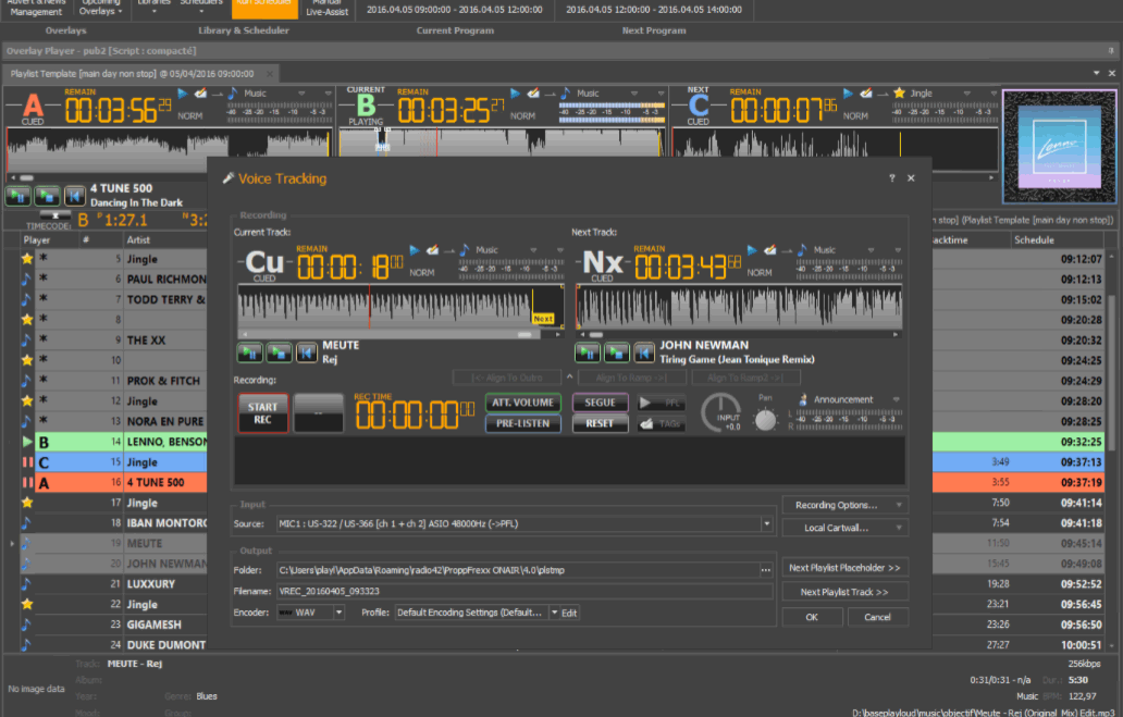

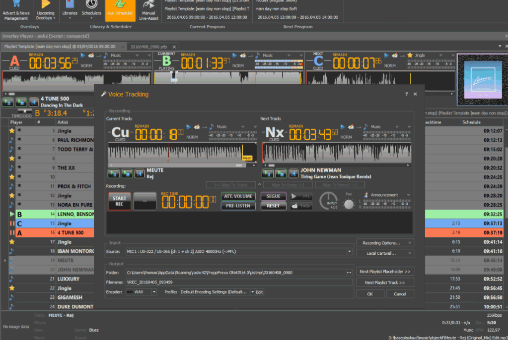

Re: bad vt folder
Thanks Bernd, but as said in the previous post I did that. it works for the main playlist window.
the bad VT path is only when create a playlist from the scheduler open at the same time than the main playlist running.
you can see it in the Pictures attached.
State1: voice track editor is open the path is correct
state2: Voice track editor is open the path is wrong
The only difference beetween the 2 pictures: A second playlist has been created from the scheduler.
I can open and change the path in the user settings, but it won't work, as soon as a second playlist is open from the scheduler the path is wrong in the user setting.
If I close this second playlist, the right directory is back in the user settings
- state2.gif (115.11 KiB) Viewed 11880 times
- state1.gif (120.45 KiB) Viewed 11880 times

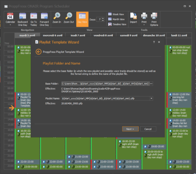

Re: bad vt folder
...hmmm. in the scripts the path to the folder is the right one...
When I try to create a playllist from the scheduler, it seems there's allready an existing one in a folder that doesnt exists.. ??!!?
- Capture d’écran 2016-04-05 à 12.03.35.png (244.51 KiB) Viewed 11875 times
Re: bad vt folder
So when you change that folder (either in the Playlist Template Wizard; or even in the Voice Tracking dialog...)
And then finish your action - it should be okay the next time...
However, the related setting is within the .userconfig file (in the ProppFrexx AppDataUser folder).. and is not directly editable (as it will be set the next time you redefine it). Its key value is "VoiceTracking" - "BaseFolder".

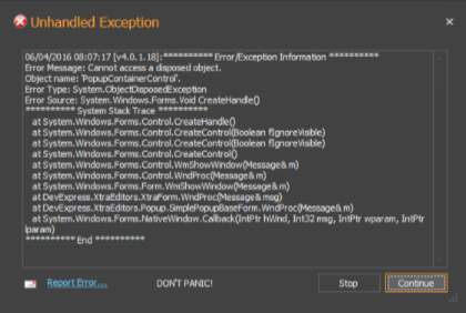

Re: bad vt folder
I wish I could... but I can't save it.
I mean it seems I can create the script, but at the end it won't show up in the script library.
Maybe this has nothing in common but I have also an error message while I'm trying to insert a script as embeded container.
- Capture d’écran 2016-04-06 à 08.08.01.png (110.2 KiB) Viewed 11857 times
