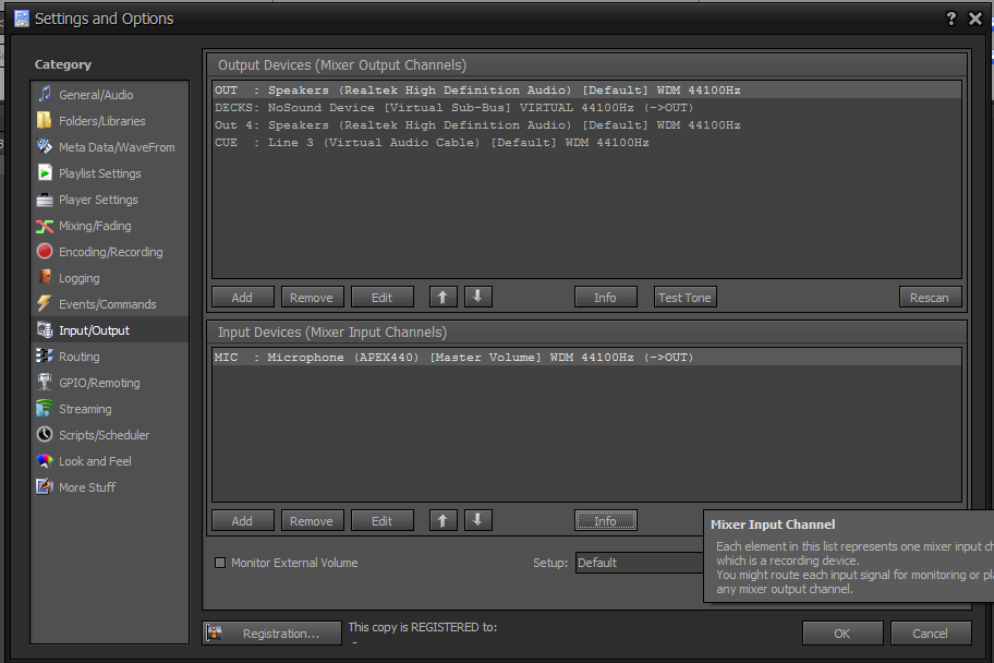

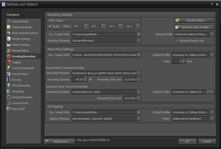

So here is the audio settings that we have set up for the mixer.. but something has got to be wrong and that's why I can't mix the music with the mic.. right? *confused*

Re: Having trouble recording
Can you hear your MIC in the OUT mixer channel?
If yes, did you try to press the REC button on the OUT mixer channel?

I've tested it the way you told me to, and it recorded the music and mic... BUT..... right after it went from one song, mic, and then another song..... the recording stopped after the mic, and started a WHOLE SEPARATE FILE for the next song.... is there something I've clicked I shouldn't have? I don't wanna have to sit and piece a 2 hour show together like a puzzle after broadcasting just to be able to put it back together and then place it into the "On Demand" lol
Seems you defined a recording sensing (right-click on the REC button of that mixer channel to redefine it)!
