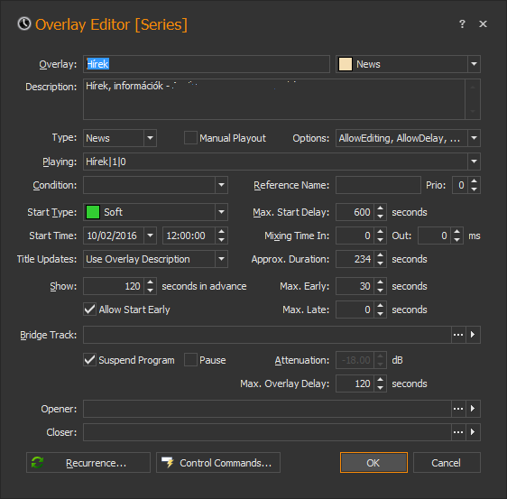

Overlay calendar + overlay closer track attached.

I use ASIO (Creative X-Fi) output with 2ms latency. I tested it with a song. I set the Next cue-pont to the last beat of the song. I left the mixing time of the overlay on 0ms. Before ~0.5s of the Next cue-point the overlay opener starts which is not a big issue, but sounds silly with some songs.
Overlay closer:
Approx. 1s after the Next cue-point, overlay player stops playing w/o fading, and closes. As you can see in the attached track, the cue-out point is in the very end of the track so there's approx. 3.5secs between the Next and the Cue-out point.
(Opener/closer is set in the News management, thats why the opener/closer is empty in the attached image)
