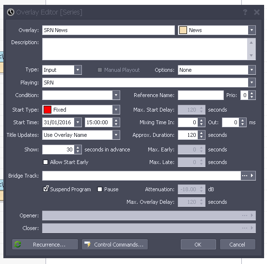

I doubled checked the settings and at the top of the hour did the same, faded out and started the next program after about 30 seconds.
Please see the configuration below, any advise would be hugely appreciated.
Overlay Config
Overlay Config
Best
Thomas
Re: Live News Stream Top of the Hour
Your settings look totally correct.
