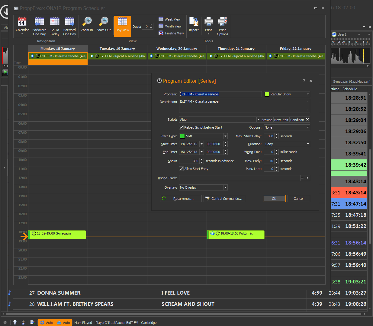

I have one "hour starter FTE" at XX:00:00 in the main script that runs all day. If any other program scheduled, PFOA run them in "Overlay EndTime Soft".

- Program scheduler
- scheduler.png (115.31 KiB) Viewed 12912 times

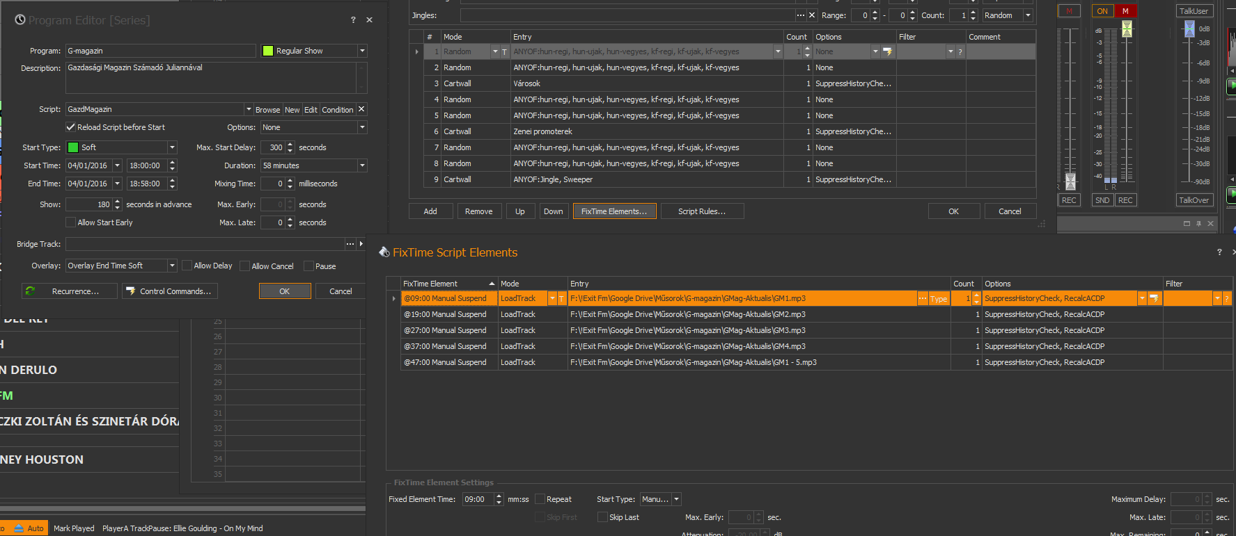

Yes, I use FTE in my overlay programs to schedule pre-recorded blocks.
Today a removed the FTE from the main script, and I added some overlays to schedule the news which ends with the hour starter jingle.
Btw this issue appeared only with the main script in totally random times. Sometimes right after the start, sometimes a few days later. But today I encountered with an other issue. One of the decks didn't unload the played track. It stucked at the end (Cue Out point). The waveform was blinking, but I had to unload it manually. After that, everything worked fine. I was wondering, could it happen if my system is overloaded? I mean, if the CPU usage is about 60%...
There was no reason to reload the main script, I unticked it.
I reload all my overlay scripts because sometimes I change it, before the program starts.
I attached a screenshot of my overlay program+script.

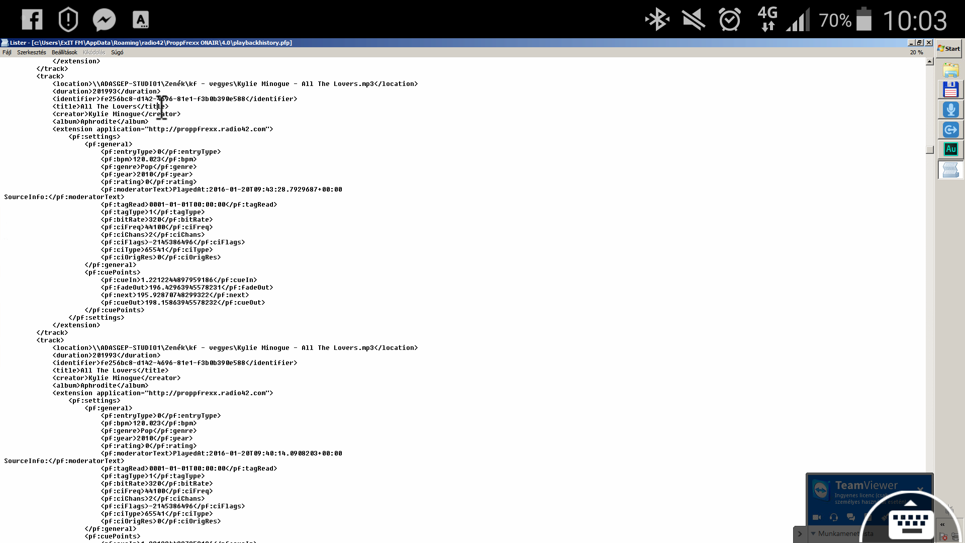

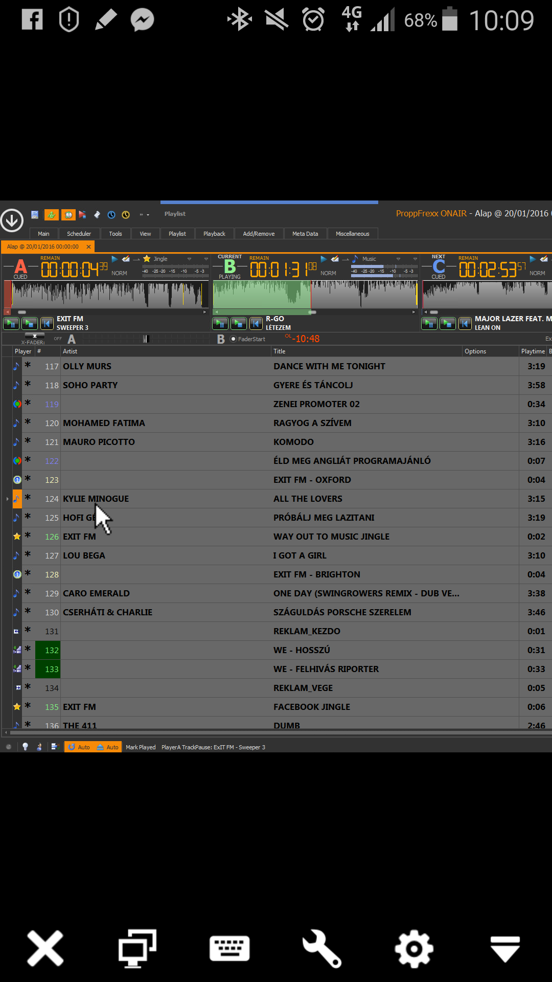

The "same track played twice" just happened today with a music. I attached a screenshot of my playlist log and the current playlist. The song added once to the playlist but played twice. I have no idea how and why.

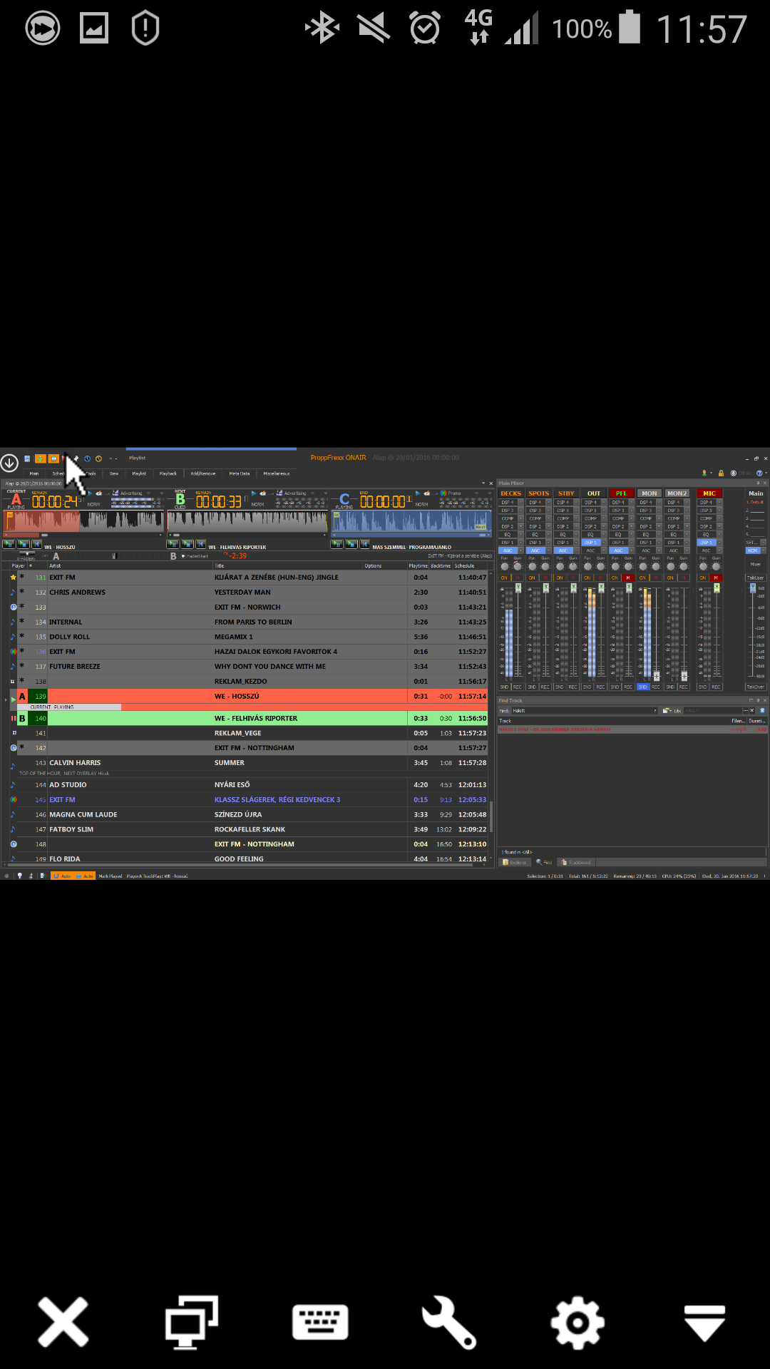

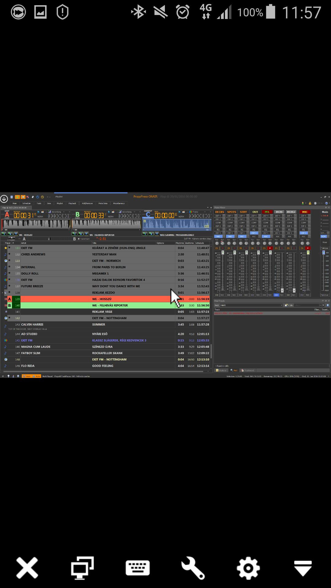

And now the second issue happened.
Last track didn't unload + next track didn't start. Seems like "Next" cue point suppressed.
I had to start it manually. Luckily the debug mode is on so hopefully its logged. I'll send the report when I get home.
