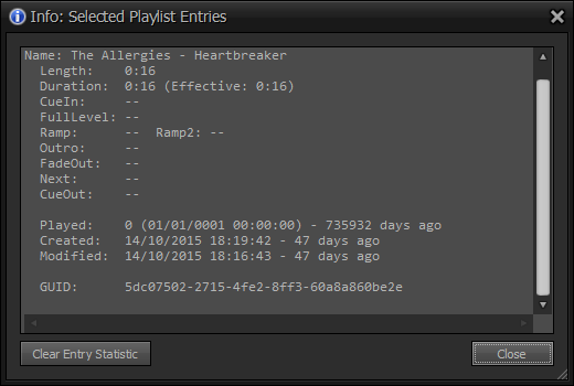

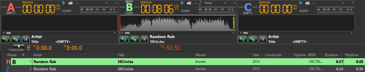

In attachment I added the same file 2 times, first loaded in a player and then just added in queue.
Little correction : the playtime is correct when it is loaded on the player.
- duration1.png (41.17 KiB) Viewed 13950 times
