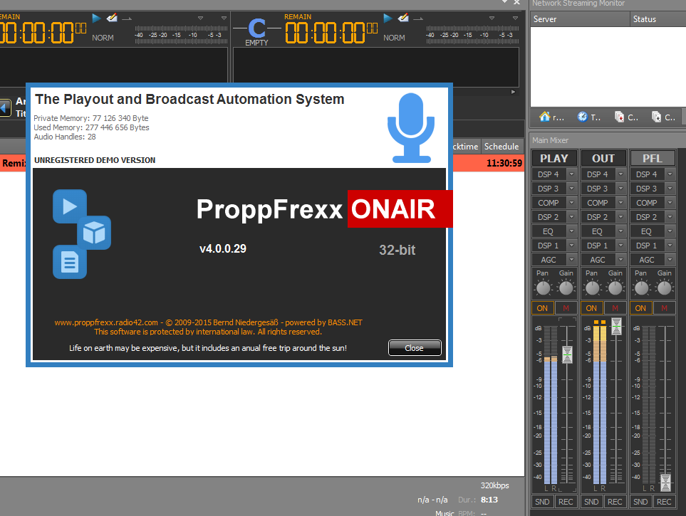

a new v4.0.0.29-beta is available (so "Check for Beta-Version...") which should hopefully fix this issue.

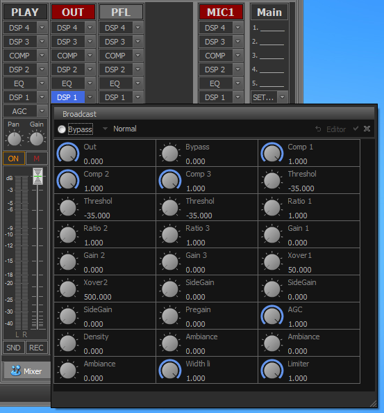

There is an other bug (but already in the previous versions) : The custom program parameters of the VST is lost sometimes, maybe due to switching profiles?
In attachment i've uploaded my files, Broadcast.mixer.bak which was saved manually and Broadcast.mixer which was saved automatically when I closed PF. You can see all parameters are lost.

Just to be sure, i was talking about these parameters :
Could you try this :
- Start ProppFrexx without any DSP, save the current Mixer Setup (eg. NoDSP.mixer).
- Load the jb_broadcast.dll DSP.
- Choose the "Default" program (after "High pressure"), rename it as you want (eg. Preset1).
- Adjust some settings (Gain, ratio,...)
- Save the mixer setup (eg. Broadcast.mixer)
- Load you previous setup (NoDSP.mixer), then load Broadcast.mixer.
In my case, only the custom "Preset1" is saved, the other programs results as the picture above.

I see, but this feature (renaming and creating your own program presets) is NOT supported by jb_broadcast
Renaming and creating your own program presets is a general VST feature, which must be supported by the VST itself. If the VST doesn't support this (persistently) there is nothing I can do.
What ProppFrexx supports is to save and restore the last settings! And this is working pretty well.
